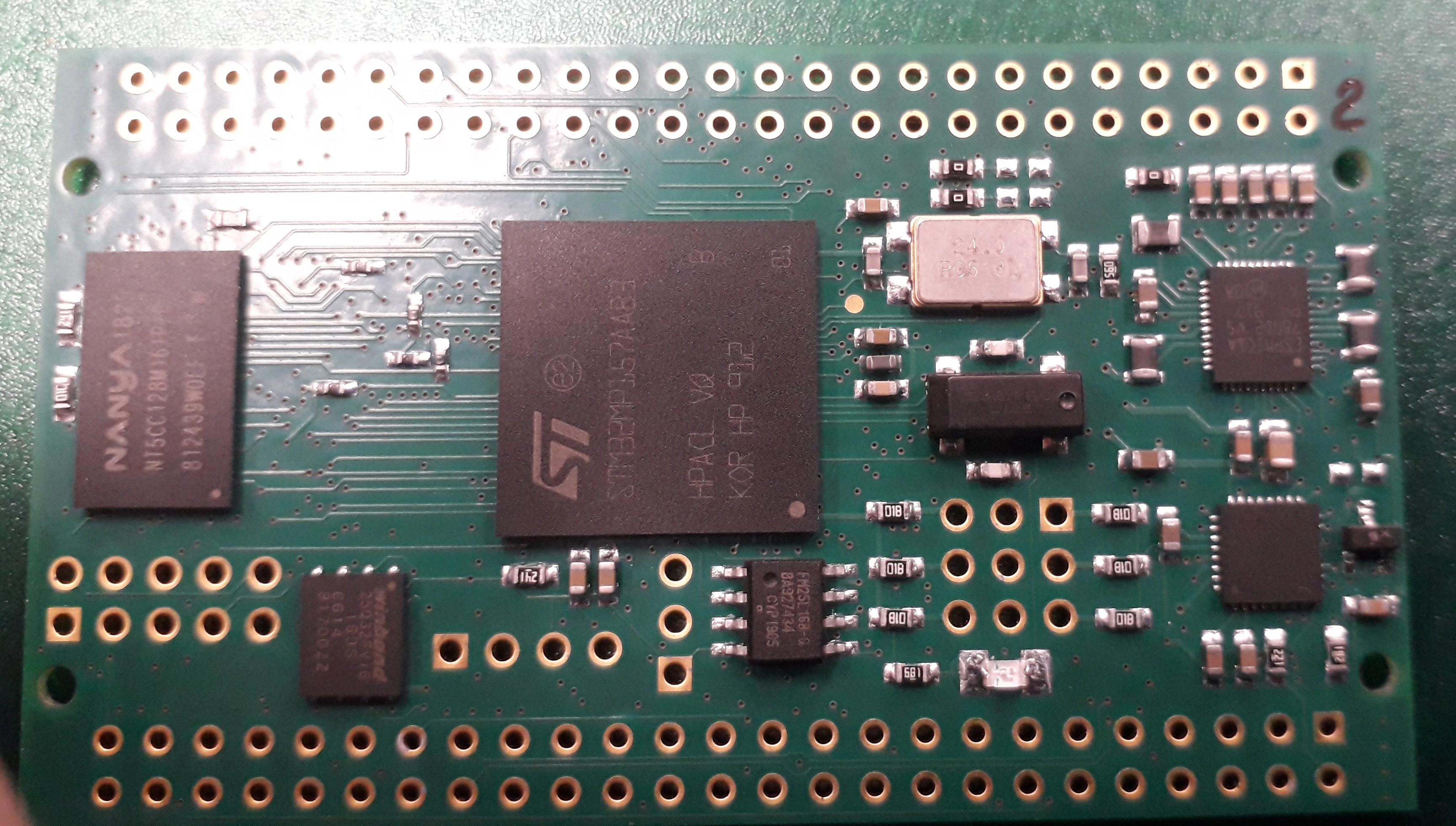

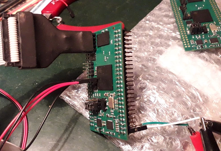

STM32MP157AAB failed to boot from NOR QSPI (bare-metal)
Hello.
Can someone explain problem by this diagnostics:
bootfailed
S-00000001C040CFFE
NS-0000000000000000
bootfailed
S-00000001C040CFFE
NS-0000000000000000
My board say these lines to PA13 pin (9600-8N1) after power up.
Flash memory contain [may be] properly formed first stage bootloader file with only infinite loop at starting point.
Binary in attachment.

Manual say:
Traces can be downloaded from address range 0x2ffc1c00-0x2ffc2404
But, area from 0x2ffc2400 declared as used for bootloader. Should I move my code?

Genadi Zawidowski
Senior
Dec 4, 2019 5:24 PM UTC
No. I mean:
If I try to power-on, I see error messages and can not connect trough USB for example.
Then I corrupt image signature - I no see error messages and can connect oved USB DFU.
PatrickF
Dec 5, 2019 12:27 PM UTC
your issue puzzled me, and after some internal discussion, I found that the full binary including header is copied in SYSRAM, so, in your case, you should put entry point to 0x2ffc2500 (as header size is 0x100, your code is offset), but still putting load address to 0x2ffc2400 (please note that load address is ignored for FSBL and 0x2FFc2400 is always used) .
Your issue is explained because by executing at 0x2ffc2400, you get bad code (header values), which end up to generate an exception (e.g undefined instruction, abort, etc..). As at this point of time, as exception table base address (VBAR) has not been changed by your own code, the exceptions are catch by BootROM, which loop to a FAIL state.
