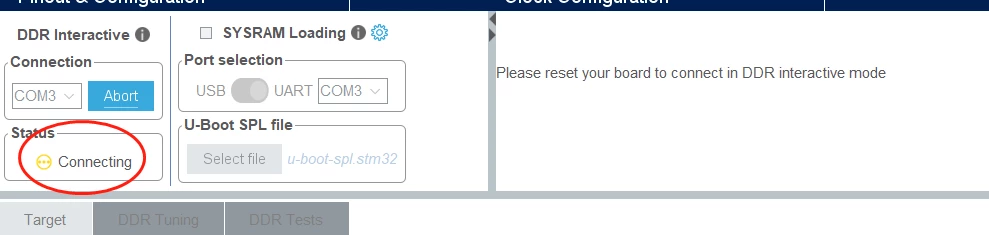

But when i used the tool for my board,i don't kown why its can't connect,the -boot-spi in sysram
PatrickF
November 6, 2019
To Connect, you need to have a running uBoot SPL (basic boot) on your board (i.e. boot from a Flash or SD-Card).
If not, you should use SYSRAM loading to get it running and connect USB (FlashProgrammer is used to load it in SYSRAM instead of loaded from Flash)
You could refer to https://wiki.st.com/stm32mpu/wiki/U-Boot_SPL:_DDR_interactive_mode and CubeMX User Manual (see 'DDR Suite' section)

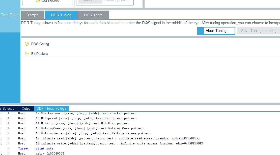

Yes,it's look great:face_with_tears_of_joy: :face_with_tears_of_joy:
but abort tuning the process is slowly?:fearful_face: 0690X00000ArjbmQAB.png
