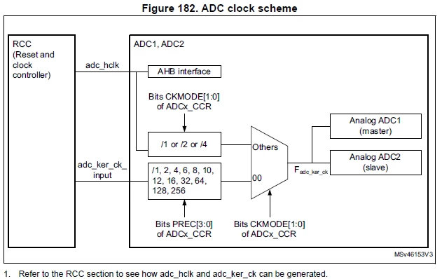

I'm porting ADC on M4, but some how the converting result is odd value always, seems the DR bit-0 is always '1'.
I tested it by VR, range from 0v to 3.3v, the ADC suppose to convert it from 0 to 255, but I don't know why, I just get odd value back, like 1, 3,5....197,199,201....255. No even number at all.
H/W configuration:
ADC Input: ANA0
Vref+ = 3.3V
Here are the ADC configuration...

PatrickF
September 22, 2020
Please check if your other platform settings are fulfilling the ADC characteristics of datasheet, especially ADC maximum operating frequency of 20MHz (or 36MHz with BOOST=1).0693W000004GgvbQAC.png
