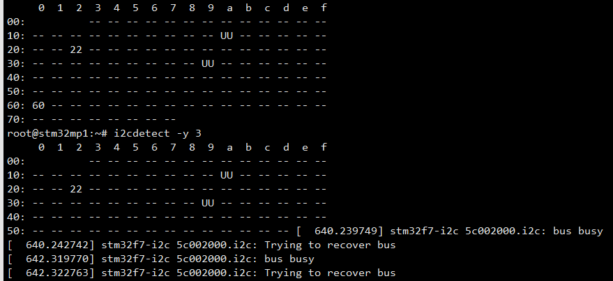

I used the i2c4 for sii9022 chip,but it always busy and don't response for hdmi plug in.
20 replies
PatrickF
December 9, 2019
I2C bus busy is usually a bus stuck to 0V, e.g. wrong Hw connection or missing power supplies on one of the I2C slave device on the bus (devices are not always "fail-safe" on their I2C pins)

No, it actually works, only to detect the bus reusable by I2C4 will time out

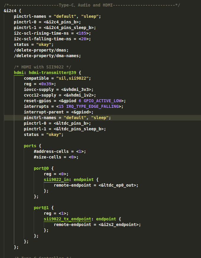

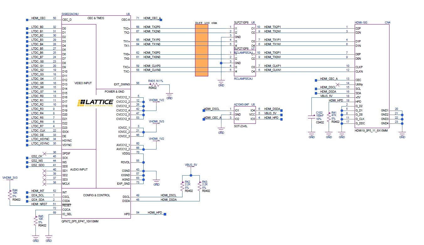

and my i2c4 dts and sch,can you help me,i spend three days but no result...:loudly_crying_face: :loudly_crying_face: :loudly_crying_face: 0690X00000AtR9AQAV.png0690X00000AtR90QAF.png

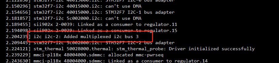

and i don't know the 9022 chip always busy,disabled the hdmi always ok.0690X00000AtR9eQAF.png

From HW point if view, I just see that CI2CA pull-down should be 4.7k whereas you have 10k. Not sure it will be the issue, but deserve to align with Si9022 datasheet value.
For SW or DT settings, I cannot help much.

My dts is ok?
