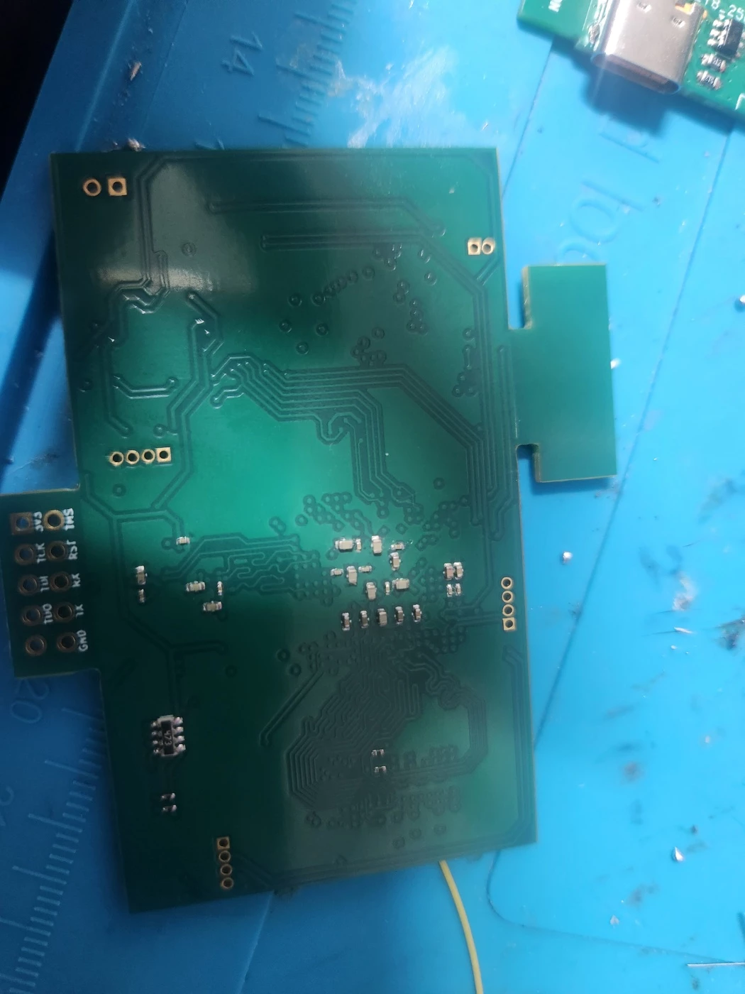

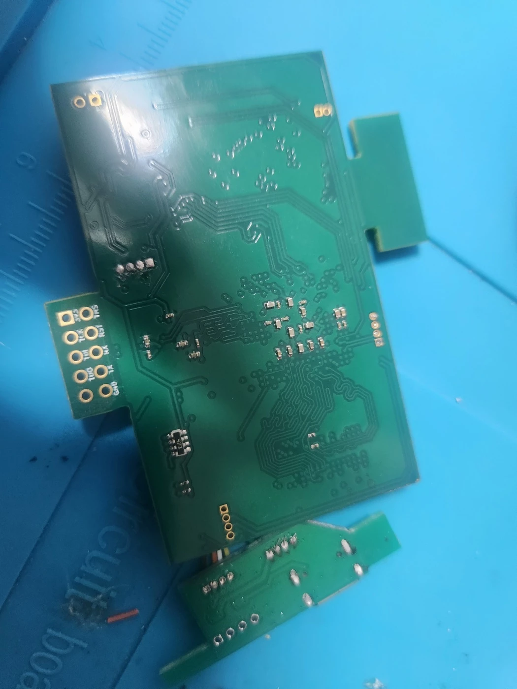

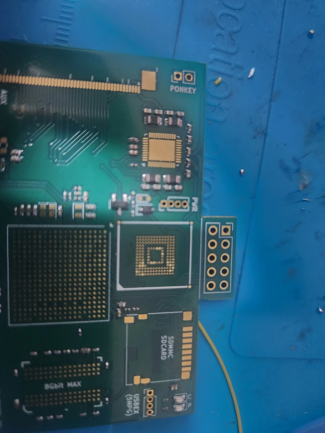

Is there a tutorial for newbie? I made my custom board by myself as hobby.
KakaoTalk_20250304_223414540.jpgKakaoTalk_20250304_223414540_01.jpgKakaoTalk_20250304_223414540_02.jpgKakaoTalk_20250304_223414540_03.jpg
the board has switches to select boot 0 and boot 1, boot 2 is tied to ground through 10k resistor. so I could implement boot selector that switches between `00` flashing mode, `01` serial NOR, `10` NAND, `11` eMMC on SDMMC2. and I tested the MPU could run as DFU mode and I could see it in Cube Programmer tool.
but I can not get understood how can I flash linux to my board.
exactly, I could build linux using yocto but, where should I put my DTS files that generated by Cube IDE?
I'm under WSL2 environment to build yocto. unfortunately, I'm not expert of linux kernel :(

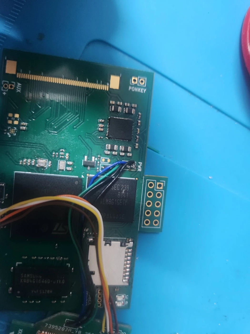

Hello, I built FIP artifacts following wiki, `STM32MPU Developer Package`, 5.2. Installing the OpenSTLinux BSP packages.
And I could get binary files:
1. TF-A binary: tf-a-stm32mp157d-smp4-mx-optee-emmc.stm32
2. OPTEE binary: tee-*.bin files
3. u-boot binary: u-boot{,-nodtb,-dtb}.bin files
I did not build linux kernel yet. I want to check PMIC's 1.35v output in current step, because I've read somewhere in ST wiki that works when TF-A is flashed.
But Cube Programmer disconnected from the device before doing something.  <-- This was soldering problem. after resoldering, its fixed.
and even more, eMMC is not detected in cube programmer.

I can not trace which step is wrong. I'll go home this evening and solder one more board to see if it's a soldering issue, but any help I can get in tracking down where the problem is coming.
Schematics:
eMMC recognition problem.
No partitions are related for eMMC. should I flash first partition and FSBL?
Or how can I check this problem?
