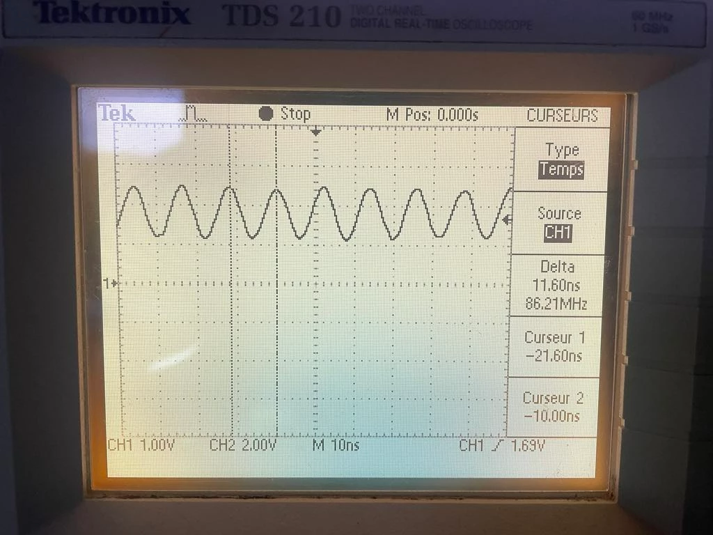

I am developing a custom board strongly inspired by the STM32MP157D-DK1, except that I use a parallel DPI RGB on 24bit display.
I use openstlinux-6.1-yocto-mickledore-mpu-v24.06.26.

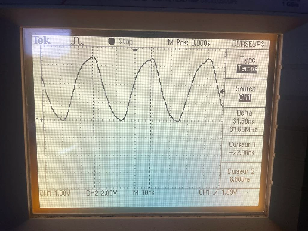

The frequency of "LTDC_CLK" changes by itself after waking up from "deep suspend".
Before putting it into "deep suspend", I measure 31.65Mhz which corresponds well to what is expected for "innolux,at070tn92"
But after waking up, i measure 86.21Mhz and this is completely outside the display specifications.
All other frequencies changed in the same proportion "HSYNC", "VSYNC", ...
Here is the configuration in the kernel and u-boot DTS file :

The rest of the devices like ethernet seem to work perfectly fine after exiting "Suspend Deep" mode
Here are the logs where we see the suspend deep and the wake-up:

I have been stuck for over a week, so I am asking you for help on this subject.
Thank you very much
