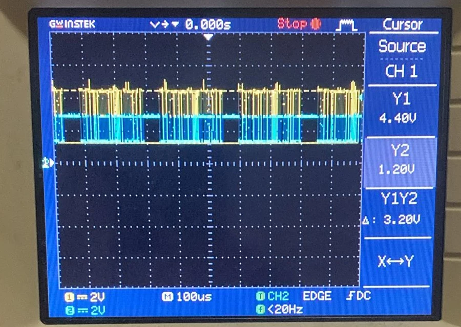

I am using a STM32MP157C development board from Myirtech and trying to interface the board with a CAN device.
I am able to bring up the can0 interface. It can send data, I can see it from oscilloscope over Can Hi and Lo pins. The dmesg output is below:

But when the device on the can bus sends data, the board does not receive anything. (I am checking by using candump can0)
Any help would be appreciated.

merttAuthor
Apr 18, 2024 17:04 UTC
The remote device is a BMS. Both sides have bus termination resistors of 120 ohms. The baud rate is 500Kbps.
The device sends data continuously. As I suspect, the remote side (STM32MP1) is not sending ACK signal.
The screen above shows Can Hi and Lo signals.

merttAuthor
Apr 20, 2024 08:01 UTC
The problem is solved, it was a baud issue.
