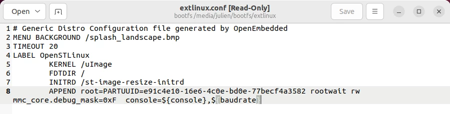

I create my custom board with STM32MP153C I try to boot but I have an issue.
Starting systemd-udevd version 255.17^
root '/dev/disk/by-partuuid/e91c4e10-16e6-4c0e-bd0e-77becf4a3582' doesn't exist or does not contain a /dev.
[ 14.557600] platform 5a006000.usbphyc: deferred probe pending
[ 14.561992] platform 5800c000.usb: deferred probe pending
[ 14.567427] platform 50001000.pwr: deferred probe pending
[ 14.572778] platform 49000000.usb-otg: deferred probe pending
[ 14.578559] amba 58005000.mmc: deferred probe pending
[ 14.583629] platform 5800d000.usb: deferred probe pending
I change SD card I change some settings in device tree of kernel vqmmc-supply but I don't undestand in UBOOT I can explore my sd card

Hello Eldam,
Thank  you for your answer.
I have SDcard on SDMMC1, eMMC on SDMMC2 and WIFI/BLE on SDMMC3.
Uboot detect my SDcard on MMC0
extlinux.conf in /boot contain UID
Thank you.

OK,
the partuuid should corresond to the uuid find in your uboot.
Uuid is a bit unreadable for us, human-trying-to-understand-linux-boot, and mmcblk speaks to me.
root=/dev/mmcblk0p10 rootwait rw console=ttySTM0,115200
root=/dev/mmcblk1p10 rootwait rw console=ttySTM0,115200
The 0/1 in bold reflects the mmc id. 10 the partition id (my rootfs)
Regarding your boot cmd log, the uuid :xxx3582 should be something like mmcblk0p9 or 1p9, worth a try.

JMDAuthorBest answer
Jan 25, 2026 8:15 PM UTC
I fixed the issue by correctly configuring the secure peripherals (mainly I2C4).
The clocks were unavailable, and most peripherals would not start. This was not an eMMC issue.

JMDAuthor
Jan 26, 2026 6:09 PM UTC
Thank you, the main issue was _NSEC missing for I2C4
&pinctrl_z {
	/* USER CODE BEGIN pinctrl_z */
	i2c4_pins_z_mx: i2c4_mx-0 {
		pins {
			pinmux = <STM32_PINMUX_NSEC('Z', 4, AF6)>, /* I2C4_SCL */
					 <STM32_PINMUX_NSEC('Z', 5, AF6)>; /* I2C4_SDA */
			bias-disable;
			drive-open-drain;
			slew-rate = <0>;
	/* USER CODE END pinctrl_z */
In boot log, I have so many warning (one for each peripheral) about Z4 and Z5 pin (I2C4) and it's for this reason that some peripherals are defered
I/TC: WARNING: apply pinctrl for secure pin Z4 that is non-secure
I/TC: WARNING: apply pinctrl for secure pin Z5 that is non-secure
