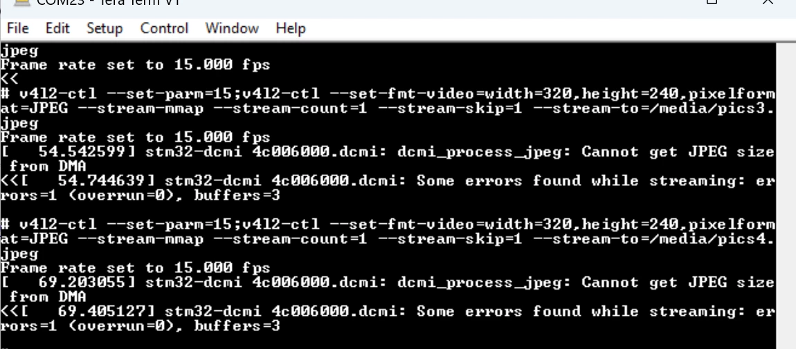

Hi, I am using STM32MP153 and DCMI interface, camera OV5640.
we are using DT same as here: DCMI device tree configuration - stm32mpu

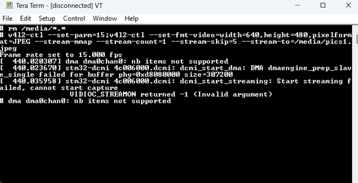

For 640x480 or higher, we always get dma error as below:
For 320x240: Seems first capture has no problem, but start from second capture, we also always have dma error as below:
does anyone know what I am missing, please?

I got dma working with resolution higher than 320x240. Problem was, I am using old kernel that using dmaengine_prep_slave_single while new version use dmaengine_prep_slave_sg.
But I still have one more problem if you know or have any hint.
In stm32-dcmi.c we have
dcmi->dma_max_burst = caps.max_sg_burst * DMA_SLAVE_BUSWIDTH_4_BYTES;
When I debug, this value give me 262080 = 65520 * 4  = STM32_DMA_ALIGNED_MAX_DATA_ITEMS * 4
Any transfer bigger than 262080 bytes will be failed.
