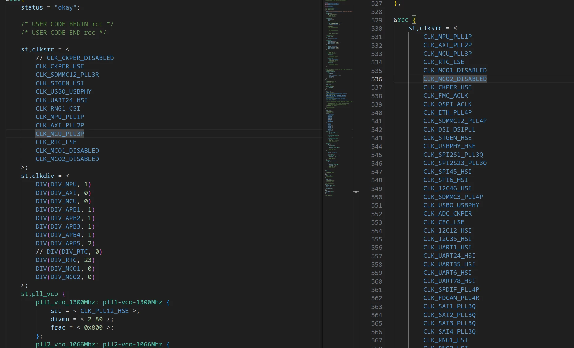

I found that DTS generated with CubeMX set CLK_CKPER_DISABLED  for OPP-TEE and TF-A instead of CLK_CKPER_HSE in DK boards while it's the same processor and almost all same peripherals although I only enabled UART4 and USB. After the change it became 24MHz, Don't know why CubeMX disabled PERI.  MX also set the RTC clock divider to 0 while for DK1 boards it is 23.
Clocks:
- MPU : 650 MHz
id=32 clock = bebc200 : 200000 kHz
- MCU : 200 MHz
- AXI : 266.500 MHz
id=30 clock = 16e3600 : 24000 kHz
- PER : 24 MHz
- DDR : 533 MHz
no matter what it did not fix my UART4 clock 151 issue. There is a big difference in clock configuration between DTS generated for a custom board from MX compared to the DTS from ST's own boards. Perhaps ST tuned the DT's for the boards and for a custom board it make it very difficult to understand where a problem could be
