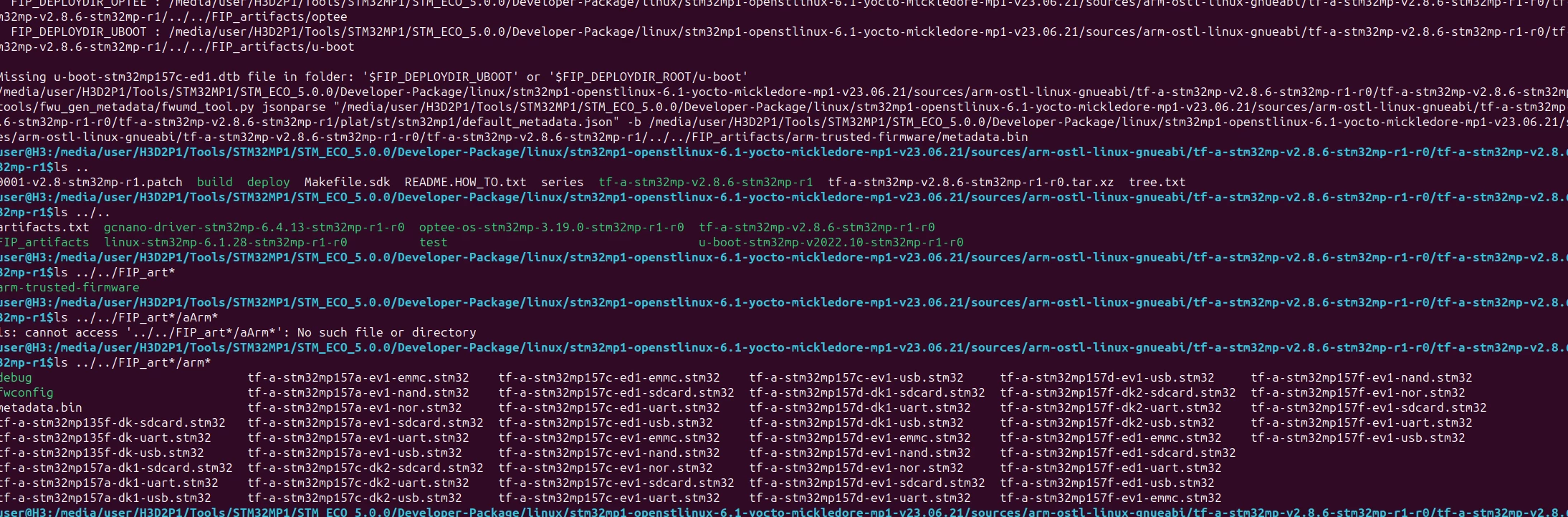

After building the TF-A from ECU 5.0.0 download (not the git). found the FIP folder and bin files. Deleted the FIP folder (export FIP_DEPLOYDIR_ROOT=$PWD/../../FIP_artifacts
After running $ make -f $PWD/../Makefile.sdk all again the FIP folder and files are not generated anymore.Also tried make clean but no resolve.
Deleted the tf-a folder, restarted everything again (untar the tar etc...and followed all from the readme again ) but still not FIP folder or  files are generated, even the build does report the files were generate (see below output)
# for some reason this does not create the FIP folder and files  after the 1st time run ! it also delets the FIP_artifacts /arm... folder if run for a 2nd time ! this is the same with optee. Why is this designed this way ? the solution might be never ever run this:

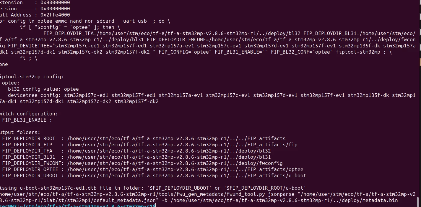

Did the whole thing again on a different drive, under the home folder. same result, no FIP_artfacts folder. attached is thelog. you can see it builds the dtb with DTC but somehow they are not in the output folders. Are you using the   the latest Developer package image or git repo ?

I guess I understand now what is going on. The ECO system sources tar file contains the FIP artifacts folder already with  u-boot and optee folder with the binaries. The TF-A make won't generate those binaries. that is why when the FIP_artifacts  folder is deleted, the u-boot and optee binary folder and files are not generated.
The generated FIP images are available in <FIP_DEPLOYDIR_ROOT>/fip
This is now correct.
TF-A makefile.sdk does not  generates any files in the output folder except for /fip. but it needs the ub-boot and optee files in that folder. So if the FIP_artifacts_u-boot or optee is deleted you need to get them again from the original ECO sources tar file. It means when building TF-A from the repo from github, it is not possible to build all files in FIP_artifacts. That means,  the u-boot and optee files must be taken from the FIP_artifacts folder in the original ECO  sources tar, The github and ECO tar file README should mention this, or at least point where those u-boot and optee binaries can be found for a successful build..(if by accident or other reason the  files are deleted). I placed those FIP_artifact u-boot and optee folders in the ../../FIP_artifacts  folder for building from the git repo and the  fip's are now correctly created. The only one exception us the on failing is for my custom board dts That is due to the .bin file missing in the optee and u-boot  folder.
