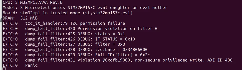

Custom STM32MP157AAA3 board,  512MB. TF-A OP-TEE in SYSRAM
Two outcomes.
[a] building u-boot with stm32mp1_trusted_defconfig : boot loops around (restart), does not even reach u-boot
[b] building u-boot with stm32mp1_defconfig: dump_fail_filter:425 Violation @0xdfb19000, non-secure privileged write, AXI ID 480

Even there is a u-boot sign on, the actual error occurs in tzc400.c in the OP-TEE code tree in the dump_fail_filter function . That was a bit misleading, I was assuming u-boot is running, and perhaps it is, but the memory access could be checked by OP-TEE code. not sure how this works but guess  OPTEE is a "service" to u-boot
it is a PRIVILEGED write but a non-secure access. I interpreted that as that caller has right to access the memory area but not for write access. Perhaps that is a wrong conclusion.
it reports filter "0" , where can this filter be found ? what is AXI ID 480 ?
io_read32(tzc.base + FAIL_ID(filter))) = 480
EMSG("Violation @0x%"PRIx64", %ssecure %sprivileged %s, AXI ID %"PRIx32,
addr,
nonsecure_not_secure(filter) ? "non-" : "",
priv_not_unpriv(filter) ? "" : "un",
write_not_read(filter) ? "write" : "read",
io_read32(tzc.base + FAIL_ID(filter)));

E/TC:0 tzc_it_handler:79 TZC permission failure
E/TC:0 dump_fail_filter:420 Permission violation on filter 0
E/TC:0 dump_fail_filter:425 Violation @0xdfb19000, non-secure privileged write, AXI ID 480
M/TC: CPU : 0

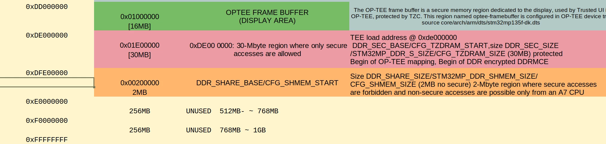

Did a complete exercise to compare the WIKI (ref "256/512MB WIKI") to the actual ECO 5.0 source code:
Ref: https://wiki.st.com/stm32mpu/wiki/How_to_configure_a_256MB_DDR_mapping_from_STM32_MPU_Distribution_Package
In make build command AARCH32_SP_OPTEE=1 and STM32MP1_OPTEE_IN_SYSRAM=1 were applied
From stm32mp15-fw-config.dtsi:
#define DDR_NS_BASE STM32MP_DDR_BASE
#ifdef AARCH32_SP_OPTEE
#define DDR_SEC_SIZE STM32MP_DDR_S_SIZE
#define DDR_SEC_BASE (STM32MP_DDR_BASE + (DDR_SIZE - DDR_SEC_SIZE))
#define DDR_NS_SIZE (DDR_SEC_BASE - DDR_NS_BASE)
#else /* !AARCH32_SP_OPTEE */
#define DDR_NS_SIZE DDR_SIZE
#endif /* AARCH32_SP_OPTEE */
From /plat/st/stm32mp1/stm32mp1_def.h"
STM32MP_DDR_BASE U(0xC0000000)
from /plat/st/stm32mp1/stm32mp1_fip_def.h:
STM32MP_DDR_S_SIZE U(0x02000000) /* 32 MB */
from the dtsi generated by CubeMX /fdts/<board>-mx-fw-config.dts:
DDR_SIZE 0x20000000 /* 512MB */
Thus:
DDR_SEC_SIZE = 0x02000000
DDR_SEC_BASE = 0xC0000000 + (0x20000000 - 0x02000000) = 0xDE000000
DDR_NS_SIZE = 0xDE000000 - 0xC0000000 = 0x1E000000
firewall: From: https://wiki.st.com/stm32mpu/wiki/How_to_configure_TF-A_FW_CONFIG:
memory-ranges = <
DDR_NS_BASE DDR_NS_SIZE TZC_REGION_S_NONE TZC_REGION_NSEC_ALL_ACCESS_RDWR
30MB_SECURE_REGION 30MB_SECURE_SIZE DDR_SEC_SIZE TZC_REGION_S_RDWR 0
2MB_NON_SECURE_REGION 2MB_NON_SECUE_SIZE TZC_REGION_S_NONE TZC_REGION_ACCESS_RDWR(STM32MP1_TZC_A7_ID)
Issues:
[1] For 512 MB, The "256/512MB" WIKI lists for the  512MB configuration  DDR_SEC_BASE = 0xDE200000 while after the source code compilation DDR_SEC_BASE results in 0xDE0000000 (de-compling fw.config.dtb also hows this value for DDR_SEC_BASE)
[2] The "256/512MB" WIKI mentions 30MB is DDR_SEC_SIZE, (0x02000000) while the actual source code this is named as DDR_NS_SIZE (non secure?) (0x01E00000)
[3] The 2MB_NON_SECURE (shared) region mentioned in the "how to configure FW_CONFIG" is missing in stm32mp15-fw-config.dtsi generated by CubeMX.
[4] DDR_SHARE_BASE is mentioned in the "256/512MB" WIKI, but not in the actual source code. It was removed from TF-A source code by a patch:
./tf-a-stm32mp-v2.8.6-stm32mp-r1-r0/0001-v2.8-stm32mp-r1.patch:8497:-#define DDR_SHARE_BASE (STM32MP_DDR_BASE + (DDR_SIZE - DDR_SHARE_SIZE))
./tf-a-stm32mp-v2.8.6-stm32mp-r1-r0/0001-v2.8-stm32mp-r1.patch:8501:-#define DDR_SEC_BASE (DDR_SHARE_BASE - DDR_SEC_SIZE)
./tf-a-stm32mp-v2.8.6-stm32mp-r1-r0/0001-v2.8-stm32mp-r1.patch:8531:- DDR_SHARE_BASE DDR_SHARE_SIZE TZC_REGION_S_NONE
[5] For OP-TEE and U-BOOT optee_framebuffer: where and how can this address be determined ? Based on the "256/512MB" WIKI this should be DDR_SHARE_BASE but based on the actual source code (see above) this is the same as DDR_SEC_BASE (0xDE000000 for 512MB), that should not be correct.
[6] in U-bOOT: in the "256/512MB" WIKI the optee region is defined as DDR_SHARE_BASE, but this is removed in the source code by the patch. How can this address and size be determined ?
I could have something wrong, but ST please take a look at these. Due to this I am not able to configure the DT's correctly. Please add a WIKI how to configure U-BOOT, FW-CONFIG and OPTEE DT for STM32MP157 with  512MB. Thank you.

Several patches had been made in the code related to shared optee memory. As you can calculate these patches removed the "shared" memory definitions. it looks like the coders could not make their mind up how to structure the definitions for the memory map. if these definitions were not removed  the calculations would be:
DDR_SHARE_SIZE STM32MP_DDR_SHMEM_SIZE
STM32MP_DDR_SHMEM_SIZE U(0x00200000) /* 2 MB */
STM32MP_DDR_SHMEM_SIZE U(0) /* empty */
DDR_SHARE_BASE = 0xC0000000 + (0x20000000 - 0x00200000) = 0xDE00000000 (?? same as DDR_SEC_BASE?)
DDR_SHARE_SIZE = 0x002000000 or 0 ?
Really don't understand how this boot code expects optee and optee_framebuffer. to be configured.

The "256/512MB" WIKI states for OPTEE:
The OP-TEE memory configuration is defined in the file core/arch/arm/plat-stm32mp1/conf.mk
CFG_TZDRAM_START ?= ($(CFG_DRAM_BASE) + $(CFG_DRAM_SIZE) - $(CFG_TZDRAM_SIZE))
= 0xc0000000 + 0x10000000 - 0x1e00000 = 0xce200000
CFG_SHMEM_START  ?= ($(CFG_TZDRAM_START) - $(CFG_SHMEM_SIZE))
= 0xce200000 - 0x200000 = 0xce000000
These definitions are not in the conf.mk for for STM32MP15

My best guesses are
1. That the memory map is as follows:
2. that for the DT's the following values should be used:
OPTEE_FRAMEBUFFER: = 0xDD000000 size 0x01000000 (in u-boot DT "optee-framebuffer)
DDR_SEC_BASE  / SIZE =  0xDE000000 0x02000000  (in optee and uboot DT for "optee" and fw-config.dts firewall)
DDR_SHARED_BASE / SIZE = 0xDFE00000 0x00200000 (in fw-config firewall)
3. That the regions in the firewall in (in board-fw-config.dtsi) should be defined as follows:
//#define DDR_SEC_SIZE STM32MP_DDR_S_SIZE
//#define DDR_SEC_BASE (STM32MP_DDR_BASE + (DDR_SIZE - DDR_SEC_SIZE))
#define DDR_SHARE_SIZE 0x00200000
#define DDR_SEC_SIZE (STM32MP_DDR_S_SIZE - DDR_SHARE_SIZE)
#define DDR_SEC_BASE (STM32MP_DDR_BASE + (DDR_SIZE - DDR_SEC_SIZE - DDR_SHARE_SIZE))
#define DDR_SHARE_BASE (DDR_SEC_BASE + DDR_SEC_SIZE)
That is:
DDR_NS_BASE = 0xC0000000
DDR_NS_SIZE = 0x1E000000
DDR_SEC_SIZE 0x01A00000
DDR_SEC_BASE = 0xDE000000
DDR_SHARE_BASE = 0xDFE00000
memory-ranges = <
DDR_SEC_BASE DDR_SEC_SIZE TZC_REGION_S_RDWR 0
// PATCH Added for firewall shared memory 2MB area below top of DDR
DDR_SHARE_BASE DDR_SHARE_SIZE TZC_REGION_S_NONE TZC_REGION_ACCESS_RDWR(STM32MP1_TZC_A7_ID)

Conclusion,  still the same error:
U-Boot 2022.10-stm32mp-r1 (Sep 21 2023 - 11:44:11 +0800)
CPU: STM32MP157AAA Rev.B
Model: STMicroelectronics STM32MP157C eval daughter on eval mother
Board: stm32mp1 in trusted mode (st,stm32mp157c-ev1)
DRAM: 512 MiB
E/TC:0 dump_fail_filter:425 DEBUG: status = 0x1
E/TC:0 dump_fail_filter:426 DEBUG: IT_STATUS = 0x10
E/TC:0 dump_fail_filter:427 DEBUG: filter = 0x0
E/TC:0 dump_fail_filter:428 DEBUG: tzc.base = 0x34806000
E/TC:0 dump_fail_filter:429 DEBUG: FAIL_ID(filter) = 0x2c
E/TC:0 dump_fail_filter:431 Violation @0xdfb19000, non-secure privileged write, AXI ID 480
E/TC:0 Panic

These  are settings from OP-TEE conf.mk
CFG_TZDRAM_SIZE ?= 0x02000000
CFG_DRAM_BASE ?= 0xc0000000
CFG_DRAM_SIZE ?= 0x20000000
= 0xC000000 + 0x20000000 - 0x02000000 ) = 0xDE000000   => This matches the  memory map as best guessed above and  is DIFFERENT than in the WIKI https://wiki.st.com/stm32mpu/wiki/How_to_configure_a_256MB_DDR_mapping_from_STM32_MPU_Distribution_Package
0xde200000 | DDR_SEC_BASE/CFG_TZDRAM_START
 So which one is correct. the WIKI or STMCubeMX and ST's source tree code ?

In which step of these is the AXI 480 error occurring. ?  Since the error occurs in OP-TEE code it loos like step 2.
as a wild guess, put the following in u.boot.dts, but did not fix it
