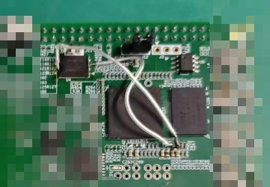

I have successfully booted from NAND by initially soldering 2 pullups, one for the nWP and one for the nHOLD noting that with a pullup only on nHOLD it does not boot. So I proceeded with the OTP value programming, configuring just the high speed pull-up and the proper mux for the QSPI bus:
 fuse override 0 5 0x4B95 4F95
Lastly I successfully booted without changing the bit[0] of word 3 for QSPI default mask flag.
Thank you very much for the help @PatrickF

Visitor
Aug 28, 2026 9:41 AM UTC
​@Patsaoglou
I am using STM32MP135DAE7 together with a Winbond W25N01GVZEIG 128 MB NAND Flash chip.
I have encountered the following issue: no logs are printed on the console when booting from NAND Flash, whereas Linux can boot successfully via USB boot.
After adding pull‑up resistors, the board can normally boot from NAND Flash without any modification to the OPT values.
However, TF‑A‑2.6 fails to start. Troubleshooting revealed that there is a conflict between some TF‑A configurations for NAND‑Flash boot and the single‑line SPI mode I am using.
The system booted successfully only after I modified the communication protocol settings for SPI and NAND Flash.
Relevant code snippets and images are provided below.
我使用的型号是:STM32MP135DAE7+w25n01gvzeig winbond 128MB
遇到了同样的问题,在使用 NAND FLASH 启动时 console 不打印任何日志,但 USB 启动时可以进去 linux 环境,
接上拉电阻后可以正常从 NAND FLASH 启动(但是我没有修改任何一个 OPT 值),但 TF-A-2.6 启动失败,排查问题后发现是 ,另外在通过 NAND FLASH 启动时,TF-A 的一些配置和我使用单线 SPI 有冲突,并修改了 SPI 和 NAND FLASH 的通信协议才顺利启动,下方是我提供的代码和图片
