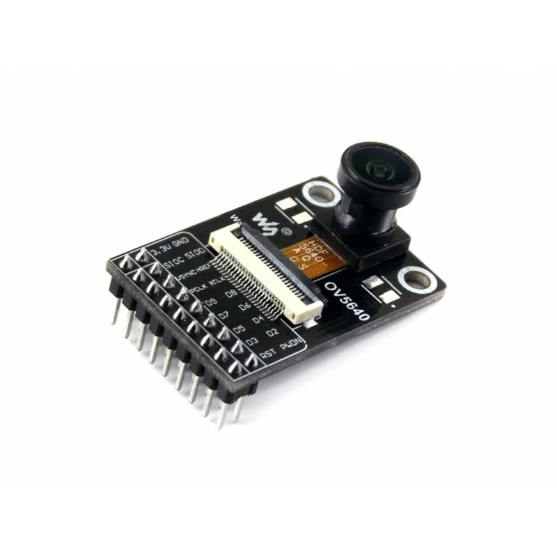

Hello
I have stm32mp135f-dk board and OV6540 camera how can I connect them

Hello thank you but I mean the physical part because camera has pins. not camera cable socket like gc2145.

Hello @kagan_senkeser ,
Do you have a link or a photo of the camera you use ?

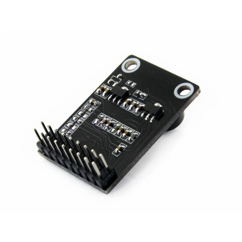

September 5, 2024
https://www.waveshare.com/wiki/OV5640_Camera_Board_(B)
I have a similar same board that came with an ST based board but never go to use it. The waveshare link May have more info. Such board use I2C (SCCB) to control and DCMI or DVP to get the pixel data and often used with FPGAs. It's is popular used with M4/M7 boards. Not sure how or if it can be used with the A7 or M4 on STM32MP lines.  Perhaps with SPI and DMA, but there is VSYNC and HSYNC /
