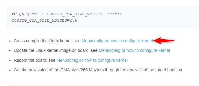

Hello all,
I already booted my image by following this link:
https://wiki.st.com/stm32mpu/wiki/Getting_started/STM32MP1_boards/STM32MP135x-DK/Let%27s_start/Populate_the_target_and_boot_the_image
Thus, I'm using kernel v24.06.26
My main goal is to modify Linux kernel and device trees, that's why I'm following below link:
https://wiki.st.com/stm32mpu/index.php?title=STM32MPU_Developer_Package
And above link directed me to below one:
https://wiki.st.com/stm32mpu/wiki/How_to_cross-compile_with_the_Developer_Package#Modifying_the_Linux_kernel_configuration
From this link, I came until this step:
And in the link that i pointed, which is:
https://wiki.st.com/stm32mpu/wiki/Menuconfig_or_how_to_configure_kernel#Menuconfig_and_Developer_Package

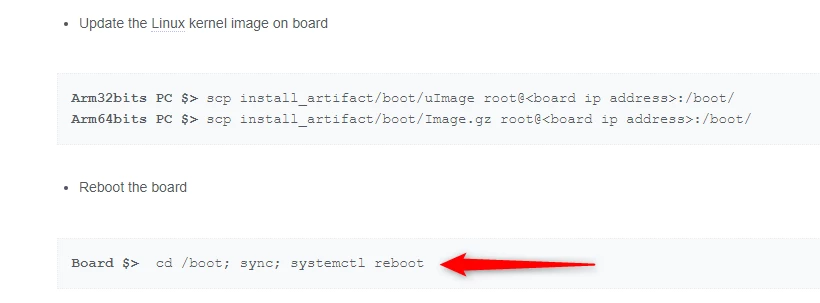

I followed the instructions, copied uImage and rebooted board like below:
However, my Linux kernel does not start, ST Logo appears and goes, and it continues like this.
Here is my logs:
