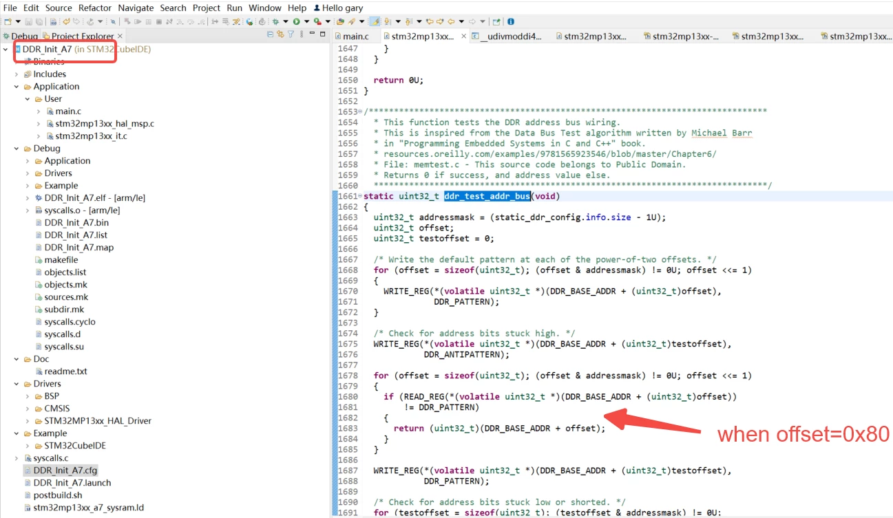

hello,my custom board use the same ddr as STM32MP135F-DK board. but when I debug the example DDR_Init_A7.erro occus when verify data in address 0xc0000000 + 0x80。as show in picture.pls help me

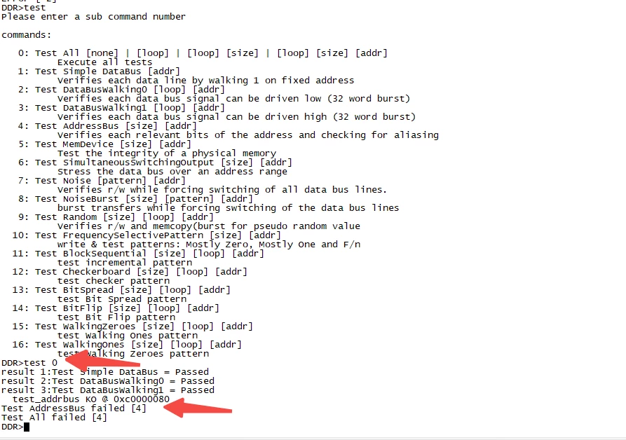

DDR range:0xc0000000 --->0xc0000000 + 0x80  is ok. so i think routing has no problem.but i could no understand why   0x80---->512M   have problem
and DDR_TEST as follow:

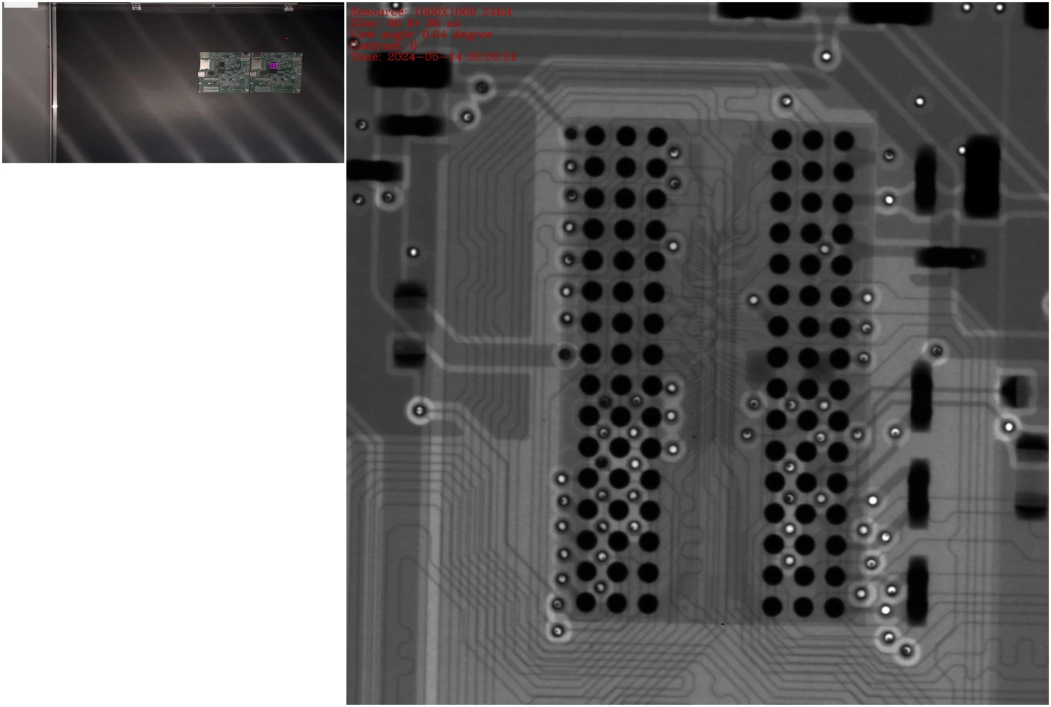

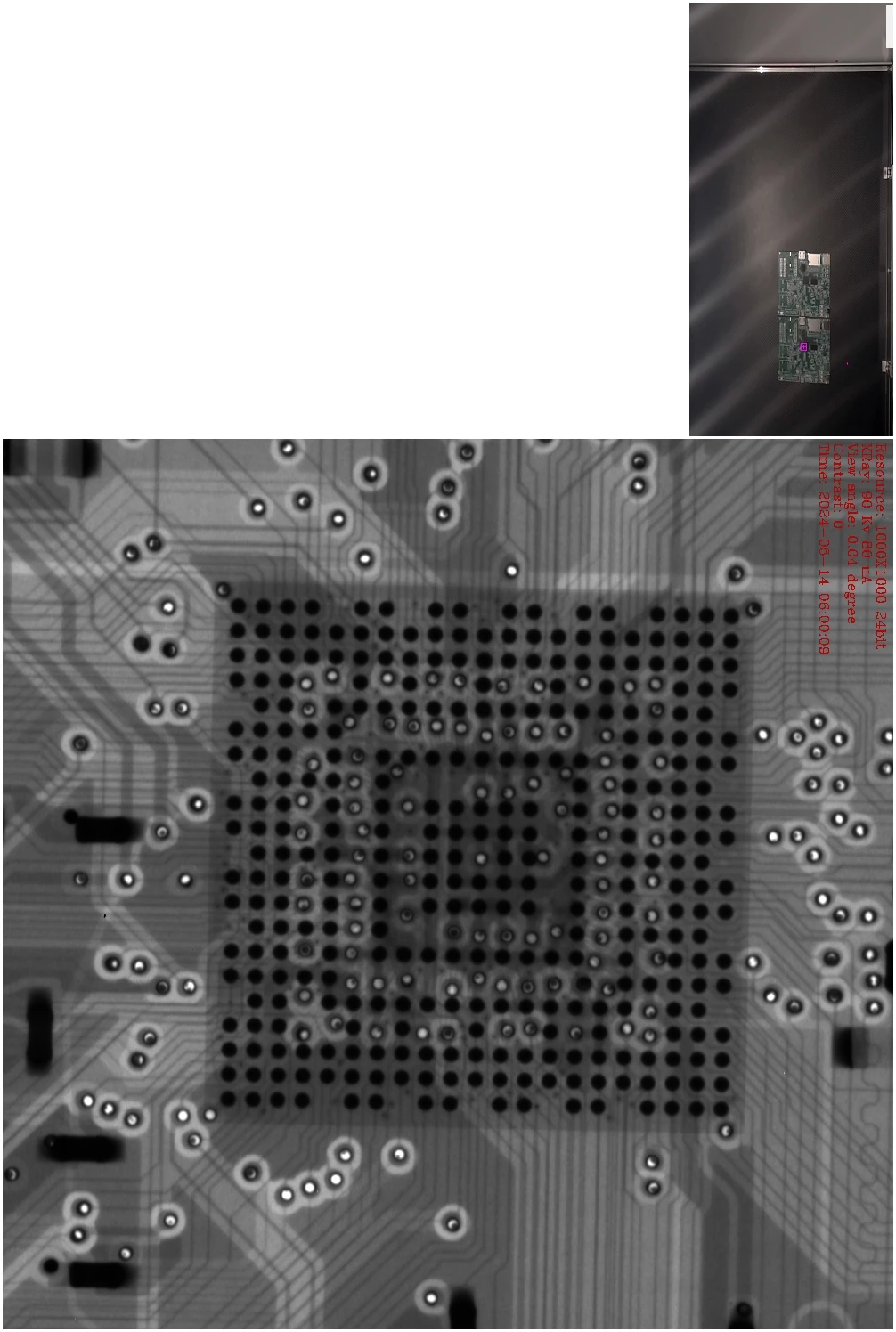

It seems clear that you have an issue with some DDR Address lines stuck to fixed level or short to something else. Maybe bad soldering somewhere. Check all DDR_Ax (and maybe DDR_BAx as well) path.
Did your assembly manufacturer do some checks after soldering ?
As issue is probably below one of the BGA package, an X-Ray analysis might be needed.
Regards.

  From x-ray picture can not see solding problem clearly.
