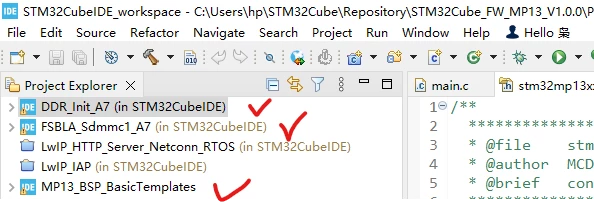

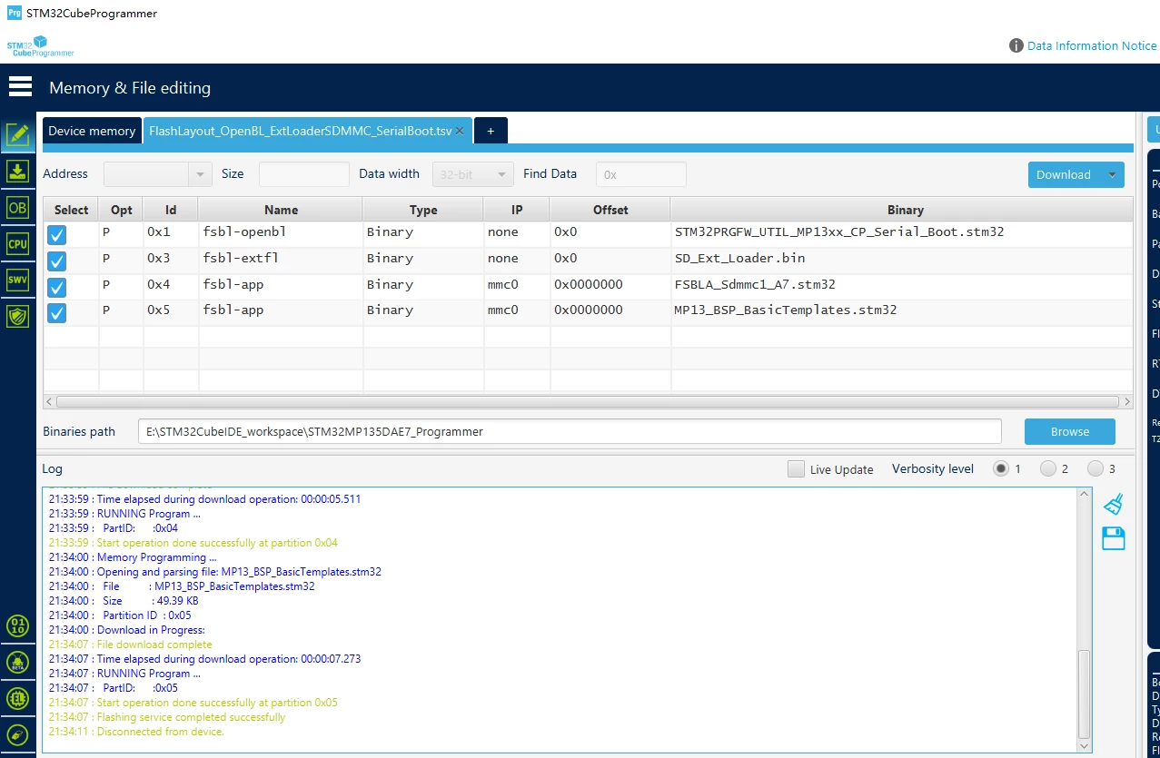

Online run successful (FSBLA_Sdmmc1_A7, MP13-BSP_BasicTemplates, DDRInit-A7).Successfully burned SD card, but it did not run。
Using chip STM32MP135DAE7。
Modified #define USE_STPMIC1x  1U to #define USE_STPMIC1x   0U, Other unchanged.

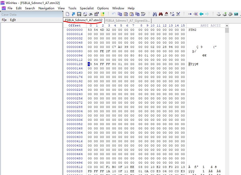

The starting position of SD card 128LGA has the same data。
What checks do I need to perform? The chip used is different from the official board(use STM32MP135DAE7)。

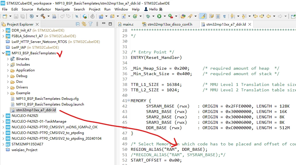

HI @Olivier GALLIEN
At present, in engineering mode, FSBLA_Sdmmc1_A7 runs successfully, can copy application program (MP13-BSP_BasicTemplates) from SD card LBA640 location to DDR, and the application program runs normally in DDR. The serial port information added in MP13-BSP_BasicTemplates is displayed normally.

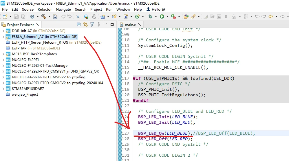

In engineering mode, FSBLA_Sdmmc1_A7 program can light the LED light, currently because the PF15 pin is connected to the JTAG (TMS) and SD_DETECT of the SD card at the same time, resulting in SD card insertion, can not run in engineering mode.
However, after the FSBLA_Sdmmc1_A7.stm32 was burned into the SD card and started from the SD card, the LED light did not turn on. Not sure if the program is started by ROM.
Plan to disconnect SD_DETECT temporarily on the hardware, run FSBLA_Sdmmc1_A7 program completely and successfully in engineering mode, and test again.
If the FSBLA_Sdmmc1_A7 program starts successfully in SD card mode, the LED should light up (the LED can light up in engineering mode).
