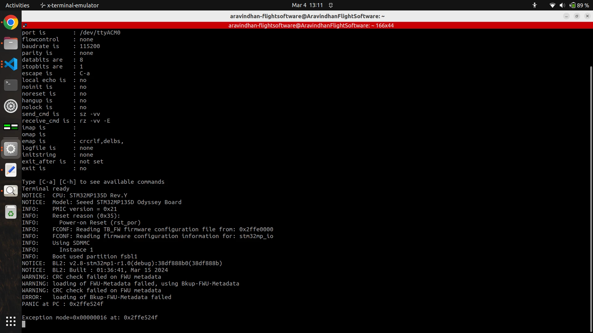

Hi, I was boot STM32MP135D-ODYSSEY with SD as boot option,using https://wiki.st.com/stm32mpu/wiki/STM32MPU_Distribution_Package and added odyssey dts. facing CRC check failed on FWU metadata and ERROR: loading of Bkup-FWU-Metadata failed. Can you help me with this.  ----

NOTICE: CPU: STM32MP135D Rev.Y
NOTICE: Model: Seeed STM32MP135D Odyssey Board
INFO: PMIC version = 0x21
INFO: Reset reason (0x35):
INFO: Power-on Reset (rst_por)
INFO: FCONF: Reading TB_FW firmware configuration file from: 0x2ffe0000
INFO: FCONF: Reading firmware configuration information for: stm32mp_io
INFO: Using SDMMC
INFO: Instance 1
INFO: Boot used partition fsbl1
NOTICE: BL2: v2.8-stm32mp1-r1.0(debug):38df888b0(38df888b)
NOTICE: BL2: Built : 01:36:41, Mar 15 2024
WARNING: CRC check failed on FWU metadata
WARNING: loading of FWU-Metadata failed, using Bkup-FWU-Metadata
PANIC at PC : 0x2ffe524f
Exception mode=0x00000016 at: 0x2ffe524f

Hi @aravindhan ,
Could it be similar to Solved: STM32MP157F-DK2 failing to boot on custom image - STMicroelectronics Community ?
Olivier
March 5, 2025
Hi, thanks for the reply. Here Solved: STM32MP157F-DK2 failing to boot on custom image - STMicroelectronics Community he missed to add metadata.bin file, but I have added the file. Here is my Partition table:
Number Start (sector) End (sector) Size Code Name
1 34 545 256.0 KiB 8301 fsbl1
2 546 1057 256.0 KiB 8301 fsbl2
3 1058 1569 256.0 KiB FFFF metadata1
4 1570 2081 256.0 KiB FFFF metadata2
5 2082 10273 4.0 MiB FFFF fip-a
6 10274 18465 4.0 MiB FFFF fip-b
7 18466 19489 512.0 KiB FFFF u-boot-env
8 19490 150561 64.0 MiB 8300 bootfs
9 150562 183329 16.0 MiB 8300 vendorfs
10 183330 8571937 4.0 GiB 8300 rootfs
11 8571938 10485726 934.5 MiB 8300 userfs
