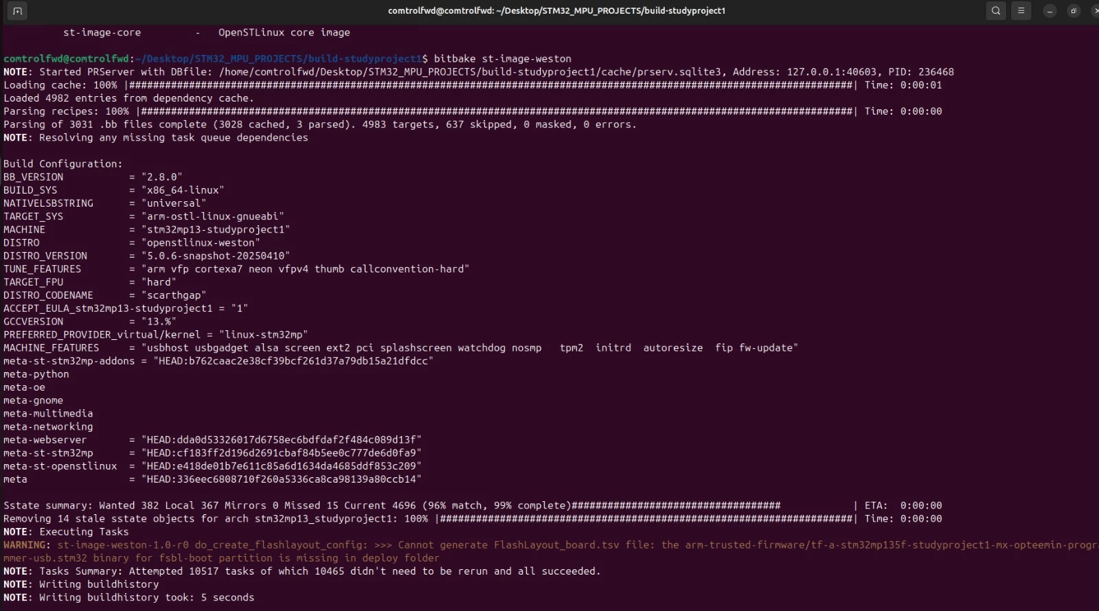

IMG-20250410-WA0010(1).jpgHi ST Community,
I’m working with the STM32MP135D-FK (Boyard) board and trying to build a Weston image using a custom machine configuration, following this official guide:
:link:https://wiki.stmicroelectronics.cn/stm32mpu/wiki/How_to_create_your_own_machine
I’m using OpenSTLinux (scarthgap) and everything builds fine, but I get this warning during the final step:
WARNING: st-image-weston-1.0-r0 do_create_flashlayout_config: >>> Cannot generate FlashLayout_board.tsv file: the arm-trusted-firmware/tf-a-stm32mp135f-studyproject1-mx-opteemin-program/fsbl_boot.bin is missing in deploy folder
It says fsbl_boot.bin is missing and so the FlashLayout_board.tsv file can’t be created. The build itself completes successfully otherwise.
     My questions:
  • How can I fix this issue and generate the missing fsbl_boot.bin?
  • Do I need to enable or configure something extra in trusted-firmware-a or optee-os?
  • Is there anything specific I need to add to my custom machine configuration for STM32MP135?
Thanks in advance for your support!
