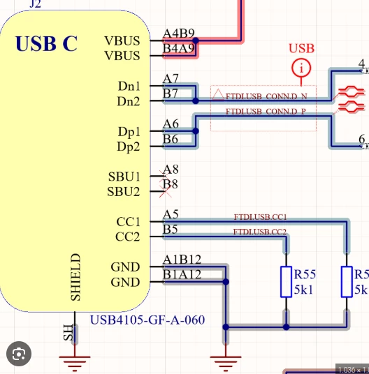

You show no circuit...so just guessing:
You have the 5k1 on the CC pins ?  otherwise typical effect: no connection to usb-c , but to usb-A working.

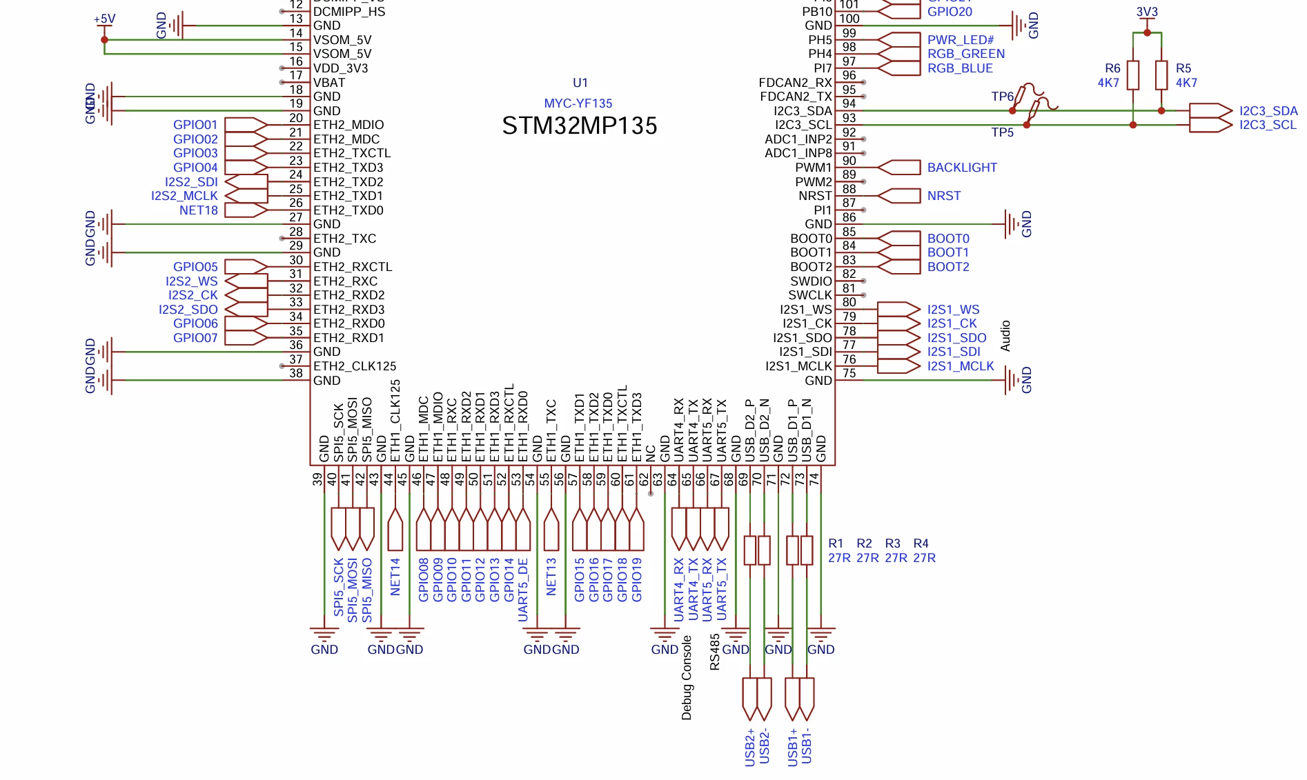

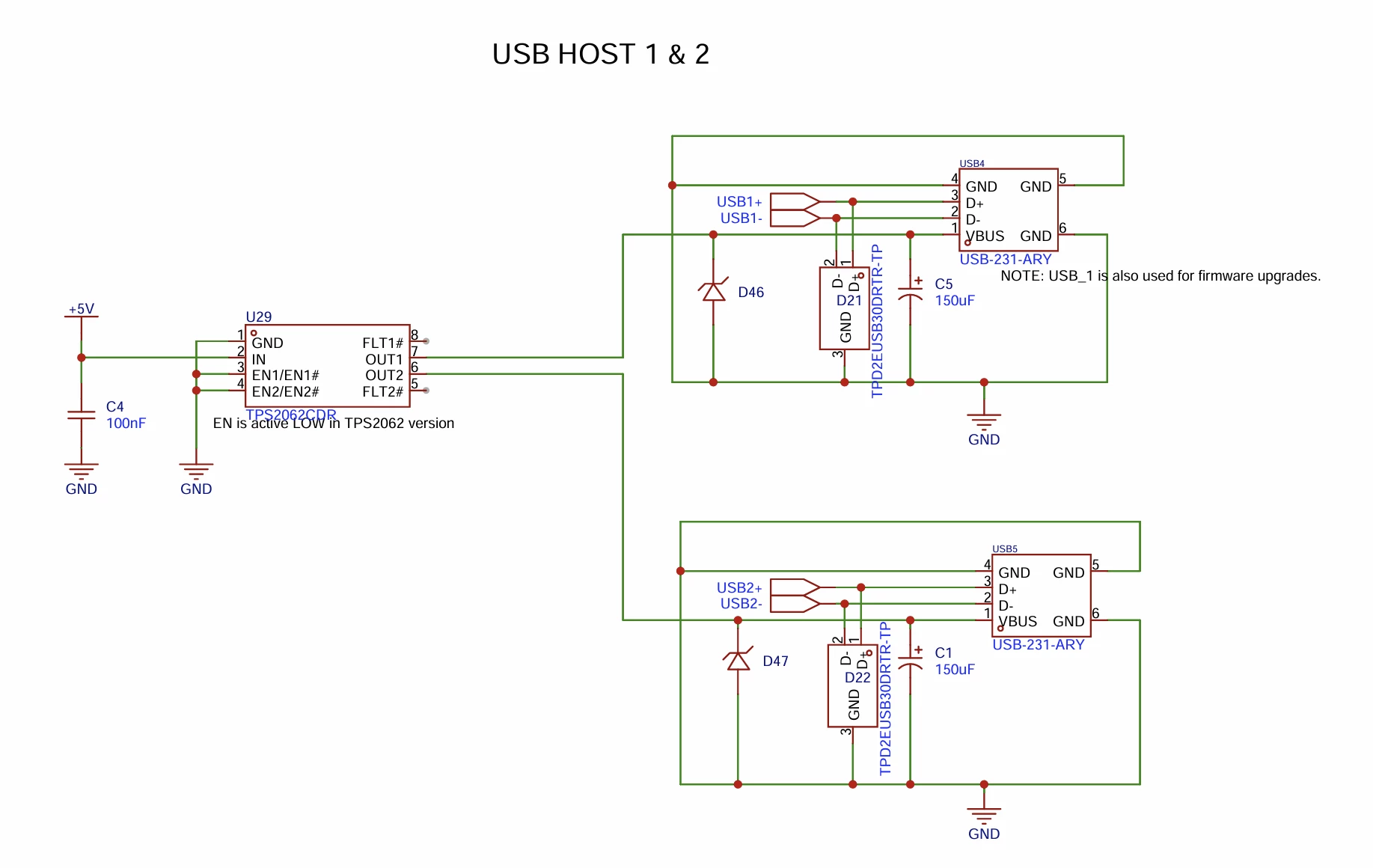

Thanks for the response. Sorry I should have included more details; here are my schematics.

Hi @TommyTom
the behavior sound normal, but it need some insight on USB behavior to understand.
My understanding is that your HW is set to use 2 x Host only port with Type-A connectors.
In that case, your application does not expose any USB OTG device in order to allows platform flashload.
Nevertheless, the HW allows to have USB OTG device connected to USB_DP2/DM2 pins
This is the setting used by the BootROM when DFU mode is used.
Issue is that USB does not allows USB device on Type-A connectors (which is only host as per standard).
The trick is to use a Type-A <-> Type-A cable to connect to a PC during DFU (such cable is not allowed as per standard, but it is ok here as only during production phase where DFU is used).
Using an (MP13) Type-A <-> Type-C (PC) does not work as (mentioned by @AScha.3 ), because the PC does not see the expected pull-downs on CC lines and so, it does not start to enumerate the device (nor supply VBUS, but here we don't care). This is required by the USB standard and any certified host with Type-C connector must follow this.
The only solution in your case should be to use either:
- a PC with Type-A connector + a Type-A <-> Type-A cable.
- a PC with Type-C connector + a Type-C to Type-A socket adapter + Type-A <-> Type-A cable. (the Type-C to Type-A adapter has internal pull-downs on CC lines)
- an USB hub with Type-A ports + a Type-A <-> Type-A cable.
Having specific setup like this is not an issue on production line.
Note that to go further on DFU for flashloading, you will need to use for 'fip-boot' a specific uBoot using USB OTG on USB_DP2/DM2 pins which will be a different uBoot that the 'fip-a/b' flashed and used on normal platform boot which will use USBH on USB_DP2/DM2 pins.
Regards.
