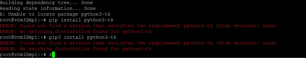

Oct 28, 2023 05:01 UTC
@PatrickF
hi sir,i am getting issue to install Tkinter .
error - E: Unable to locate package python3-tk
does we can not install Tkinter in STM32MP1 ? if there is anyway to install it then please let me know .
