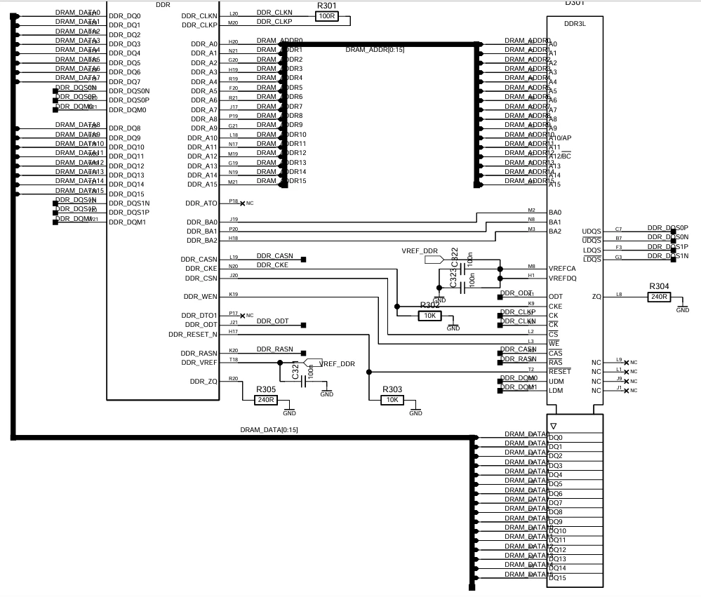

I have a custom design with STM32mp135f + MT41K256M16TW-107 DDR3L @ 533MHz that I want to bring up. I built a Linux image based on OpenSTLinux guides and it boots until my kernel is loaded (uboot logs : “starting kernel”) then its crashes without any logs even with earlycon. By testing the DDR with ST DDR Tool, I realized that byte-masked writes fail (test 9), but halfword & RMW32 work.
I noticed the byte lane swap but it is identical on the dk board. I am a bit lost and don’t know if the issue is timing/config related or due to my hardware design.

could you share the complete MP13/DDR3L schematic parts where we could see all DDR signals as with only the information above there is still possibility of wrong swap (data/DQS/DQM should always be together).

TP1Author
Jul 27, 2026 8:25 AM UTC
Hi ​@PatrickF,
Here is the DDR schematic :
From what I can tell, it looks similar to the layout of stm32mp135f-dk but the DDR models are different.
Thank you for your help,
Regards.

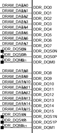

PatrickF
Jul 27, 2026 8:42 AM UTC
Hi ​@TP1
unfortunately, what I see in your schematics is wrong and explain you byte write issues.
You did not wired the same bytes mask/strobe with associated byte data:
  • MP13 DQM0/DQS0 (DQ0-DQ7 Lower bytes write Data Mask/Data Strobe) to DDR3L UDM/UDQS (DQ15-8 Upper byte write Data Mask/Sata Strobe). This requires the data byte to be also swapped.
  • but you wired MP13 DATA0-DATA7 (Lower byte) to DDR3L DQ0-DQ7 (Lower byte)
No way to solve that by SW setting, you should correct your PCB.
see example on MP135F-DK board
MP13 side:
DDR3L side:
Regards.

TP1AuthorBest answer
Jul 27, 2026 9:43 AM UTC
Thank you ​@PatrickF for your help.
Would this rewiring be correct if I don’t swap the DQ0-DQ7 and DQ8-DQ15 data lanes ?
DQM0 <-> LDM
DQM1 <-> UDM
DDR_DQS0P <-> LDQS
DDR_DQS0N <-> LDQS#
DDR_DQS1P <-> UDQS
DDR_DQS1N <-> UDQS#
Regards.
PatrickF
Jul 27, 2026 9:56 AM UTC
Yes, this would be ok.
You should take DQ0/DQS0/DQM0 (or their alternate names LDQ/LUDM) as a 10 signals group which must be altogether. and similarly for other byte.
DDR3L don’t care about lower or higher byte meanings, but all bytes related signals should be on same byte.
Regards.
