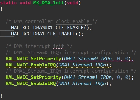

I am currently using bare-metal MP13 solution in CubeIDE. I want to integrate uart with DMA. After configuring DMA settings for uart4, a following fragment of DMA init code has been generated:
NVIC is not available for Cortex-A, but still its functions are being generated.
My question is, how can I properly adjust MX_DMA_Init for uart interrupts without NVIC and code generation?
Do you have any ideas?

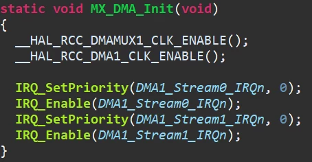

For anyone encountering the same problem here is the solution:
Enable ETZPC and add init function to the main (It won't be generated)
Make sure DMA Init runs before UART Init.

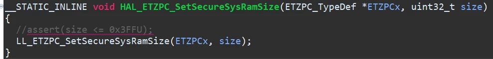

If your compiler doesn't see an assert in a scope, comment it out
Adjust MX_ETZPC_Init:
In the end, correct generated MX_DMA_Init accordingly to your own settings.
Best,
Erwan SZYMANSKI
