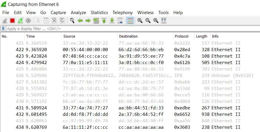

After enabling the clock, eth2 wakes up. In wireshark, I can see data being transferred and the interface's LED blink. The thing is, the visible data is an uncontrolled spam of bytes that does not stop.

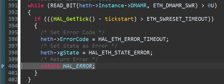

I am also getting an error in this section of code:
The SWR bit is always 1, so the eth2 can't be reset.

I have managed to make some progress.
My clock was configured to 50 MHz, but after reading the frequency with an oscilloscope it was exactly more than 51 MHz. After configuring PLL4 to work with HSE instead of HSI, there is no byte spam anymore.
At the end, it didn't solve my problem. I am still receiving an error:

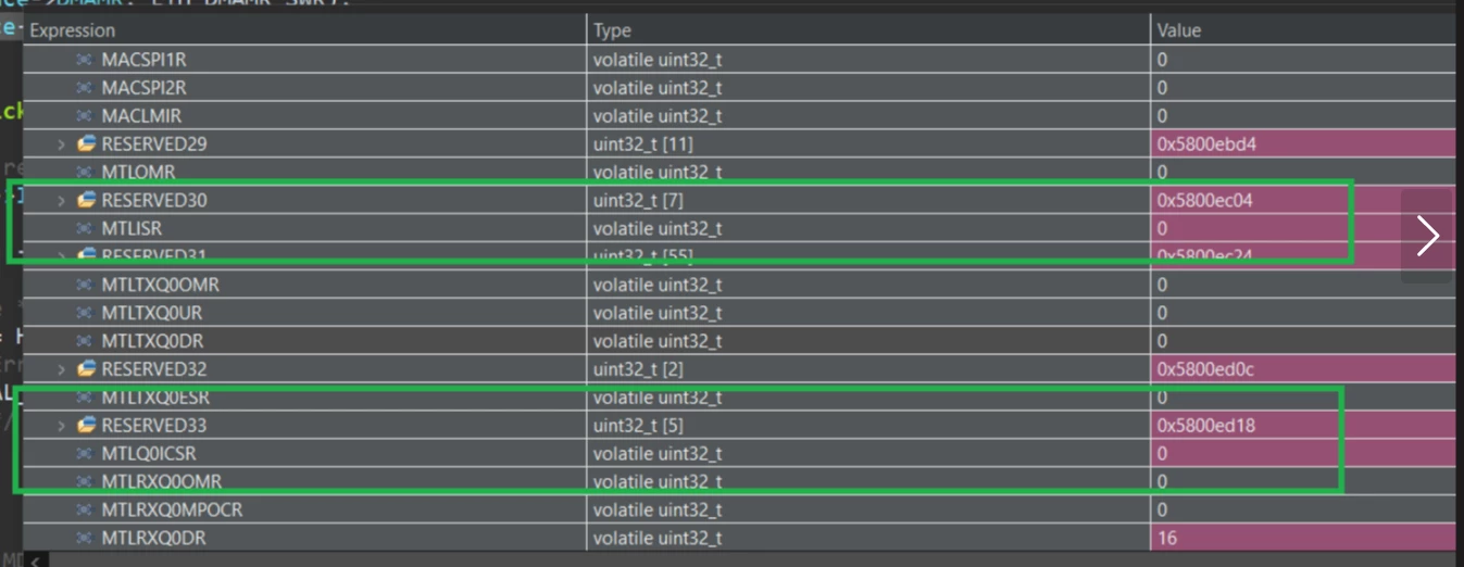

I think there is something wrong with rcc and syscfg.
After using HAL_SYSCFG_ETHInterfaceSelect(SYSCFG_ETH2_RMII); I don't see Interrupts being activated (which are for eth1)

I found the solution:
With the bit being set, I could manage to get through the eth2 init function.

10. Now it will hang in HAL_StatusTypeDef HAL_ETH_Init(ETH_HandleTypeDef *heth)
stm32mp13xx_hal_eth.c
/* Wait for software reset */
while (READ_BIT(heth->Instance->DMAMR, ETH_DMAMR_SWR) > 0U)
if (((HAL_GetTick() - tickstart) > ETH_SWRESET_TIMEOUT))
/* Set Error Code */
heth->ErrorCode = HAL_ETH_ERROR_TIMEOUT;
/* Set State as Error */
heth->gState = HAL_ETH_STATE_ERROR;
/* Return Error */
printf("6 ERROR."); // I just put info to UART terminal
return HAL_ERROR;
