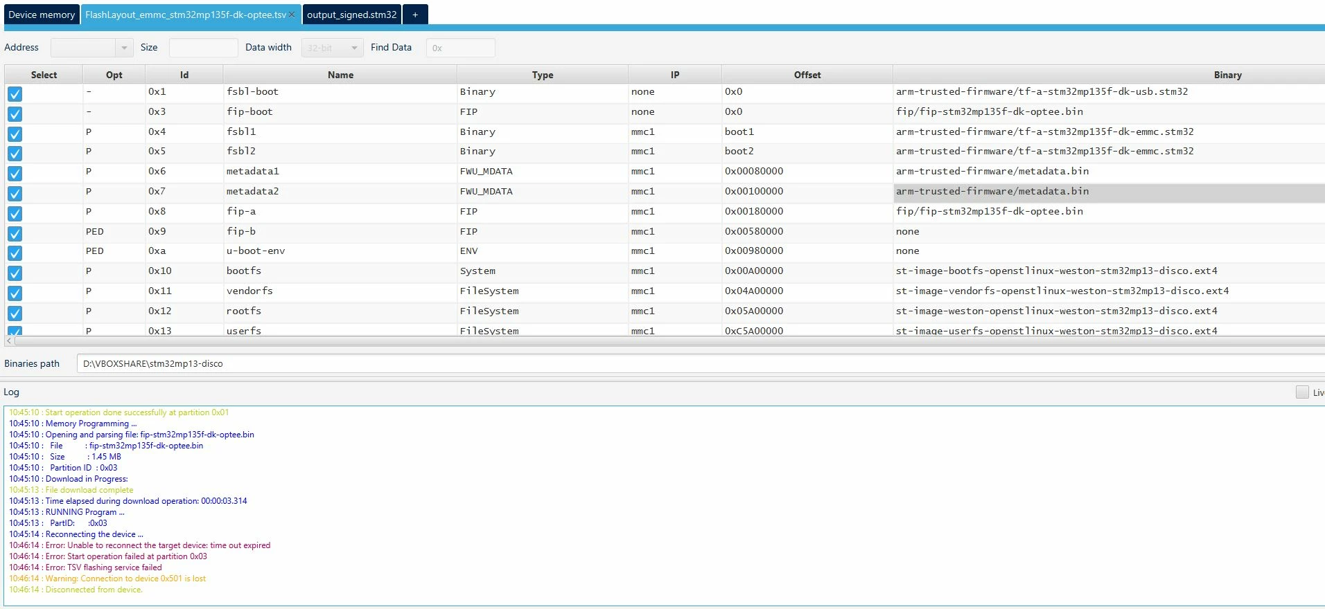

STM32CubeProgrammer's screenshot is like below.
Would you give an advise?

E/TC:0 0 process_probe_list:534 Probe DEFERED At : stm32mp1-cpu-opp
E/TC:0 0 probe_dt_drivers:752 Probe sequence result: 0x80000000
E/TC:0 0 Panic at /usr/src/debug/optee-os-stm32mp/3.19.0-stm32mp-r1-r0/core/kernel/dt_driver.c:756 <probe_dt_drivers>
E/TC:0 0 TEE load address @ 0xce000000
E/TC:0 0 Call stack:
E/TC:0 0 0xce0030f9
E/TC:0 0 0xce019b13
E/TC:0 0 0xce0188fd
E/TC:0 0 0xce01a801
E/TC:0 0 0xce002fbb
E/TC:0 0 0xce00019c
The main difference is i2c4 and i2c5.
OPTEE doesn't probe i2c5 and pmic looks doesn't work.
Why isn't i2c5 probing happening?
Thanks for reading.
