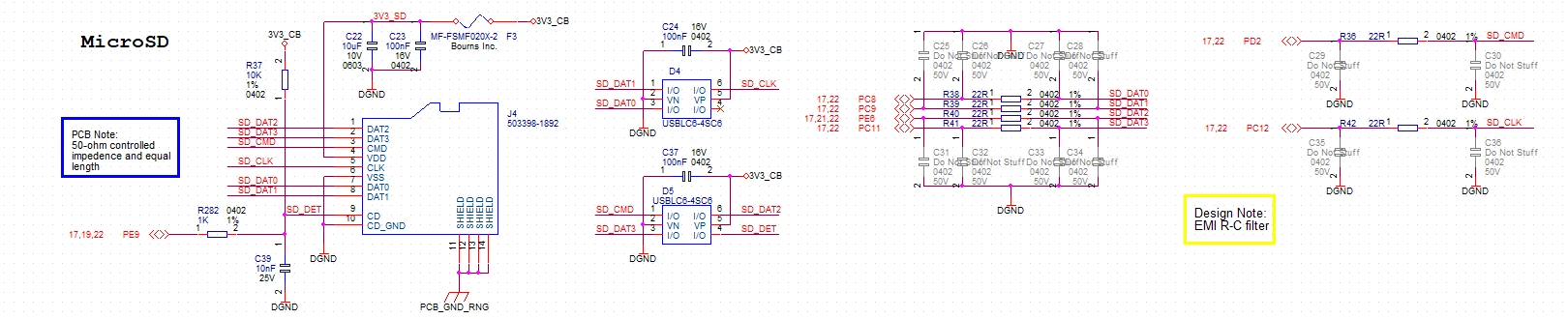

we are bringing-up our custom STM32MP157AAB3 board and we are facing some errors in linux with the uSD that it's connected to the SDMMC1 interface.
Here follows our setup:
  • HW
    • SDMMC1 cabled to a uSD connector, PE9 used as card detect
    • SDMMC2 cabled to a 4GB eMMC
    • SDMMC3 cabled to a custom connector (mainly for WiFi modules)
  • SW
    • OpenSTLinux-2.1.0
    • Custom devicetree created starting from STM32CubeMX tool with USER CODE derived from EVKs dts
    • tf-a and u-boot are read via SDMMC1
    • kernel is loaded via tftp
    • RFS is mounted via NFS
When we insert the uSD card the kernel periodically prints this error:
[ 134.448880] mmci-pl18x 58005000.sdmmc: error -110 requesting status
however the device is usable.
Using several uSD cards (of different manufacturers) we see that some are detected at the insertion and the volumes are automatically mounted, some are detected (the kernel creates the devices) but non other actions are performed (trying to manually mount the volumes stucks the tool), some other are not even detected. In the last 2 cases the bus seems to be stucked as no other uSD are detected (even the former ones) until the reboot.
So we performed some tests on the SDMMC3 bus, manually cabling a uSD connetor to the counterpart of the custom connector (with lenght mismatch and no impedance matching, this likely is a degrading configuration), dts bindigs are the same except for the missing card detect. Connecting any uSD card to this bus result in correct detect and volumes mount, no bus stuck or error prints.

  • as you did not have pull-ups on your board (as we have on our DK2), did you set pull-up on all SDMMC1 related pins inside DT sdmmc1_pins_mx and sdmmc1_opendrain_pins_mx nodes ?
bias-pull-up;
  • check card supply stability and maybe try to shortcut F3 ?

May 18, 2021 06:28 UTC
Hello Patrick,
sorry for the delay, here the schematics:0693W00000AOiqYQAT.pngand the dts:

The 22R series resistors are also present in the SDMMC3 bus (that woks fine) and I tried to replace them with 0R and 39R without any benefit.
Tell me if you need more snippets.
The tests in my first post, relative to the bus without HW detections, were indeed performed with `broken-cd` property instead of `cd-gpios`.
Our main problem isn't the card detection but the timeout errors that indicate bad performances of the device.

May 18, 2021 11:16 UTC
Hello Patrick,
you were right, I was missing the pull-up un the bus, enabling the internal pull-up will make the timeout prints much lesser but still present.
Adding external 10K pull-up has fixed the problem.
Thank you for your support.
