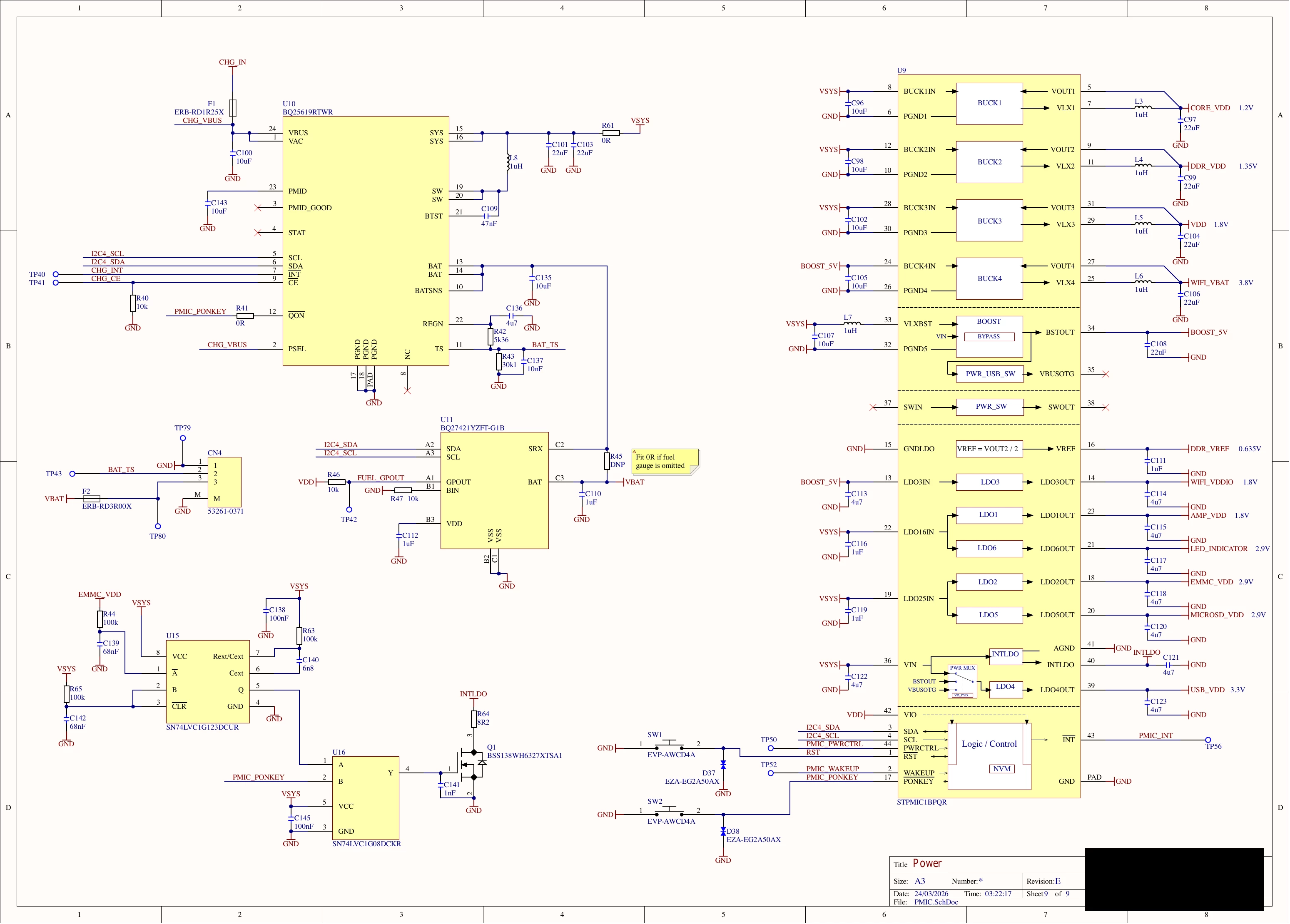

Schematics
Please see parts of our schematics attached.

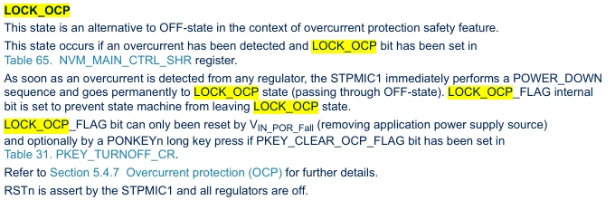

    • Would the PMIC entering the LOCK_OCP state cause this behaviour? If so, would we expect that the supervisory circuit described in AN5861 should restart the device automatically if the PMIC enters LOCK_OCP state (i.e. the monitored rail falls)?
    • If the PMIC enters the unresponsive state described in AN5861 (not LOCK_OCP), would you expect that the long press reset (PKEY_CLEAR_OCP_FLAG) would still be functional, or it would not have any effect?

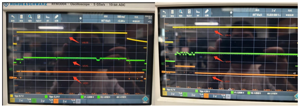

Thank you for getting back to us. We managed to get the plots now. Please find them attached.
A normal power on is shown on the left. On the right is a capture when the PMIC became unresponsive. These tests are with a nearly depleted battery (~3.1V) and a low VBUS voltage (~4.3V) connected from a lab PSU to the BQ25619 directly (the wireless charger is bypassed for the test). The conditions are the same in both tests, except minor difference in battery voltage, after repeated power on attempts the unresponsive state is achieved.

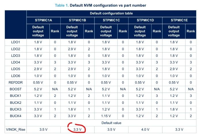

thank you for the pictures, it is evident that on the right the VBUS is affected by some spikes. The same for VBAT there is a negative spike that is triggered by the VINOK_FALL and device is turned off (VDD goes down) and it is impossible for the device to turn on again due to the low voltage of ~3.1V, see below table the default value (minimum input voltage) for the STPMIC1B version
you are talking about LOCK_OCP, if I remember well this function is not activated by default. If you use LOCK_OCP you need to follow the instruction in our DS.
Could you please redo your test at 3.3V and check again the STPMIC1B status?
If you need a lower input voltage for the STPMIC1B, you need to charge the value of the NVM content to customize the device for what the application is needed.
