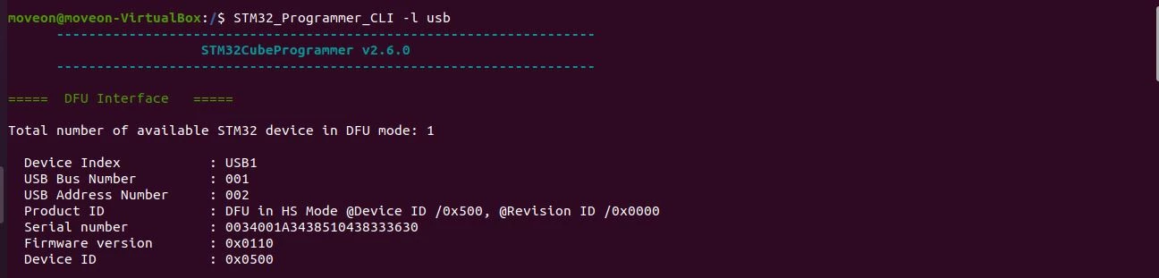

Hi KnarfB(Community Member)
Thanks for reply.
boot pins are off only.ST- L INK serial port is not showing device ID.
MVENN.1
MVENN.1Author
November 25, 2020
Please suggest the how to solve this issue.

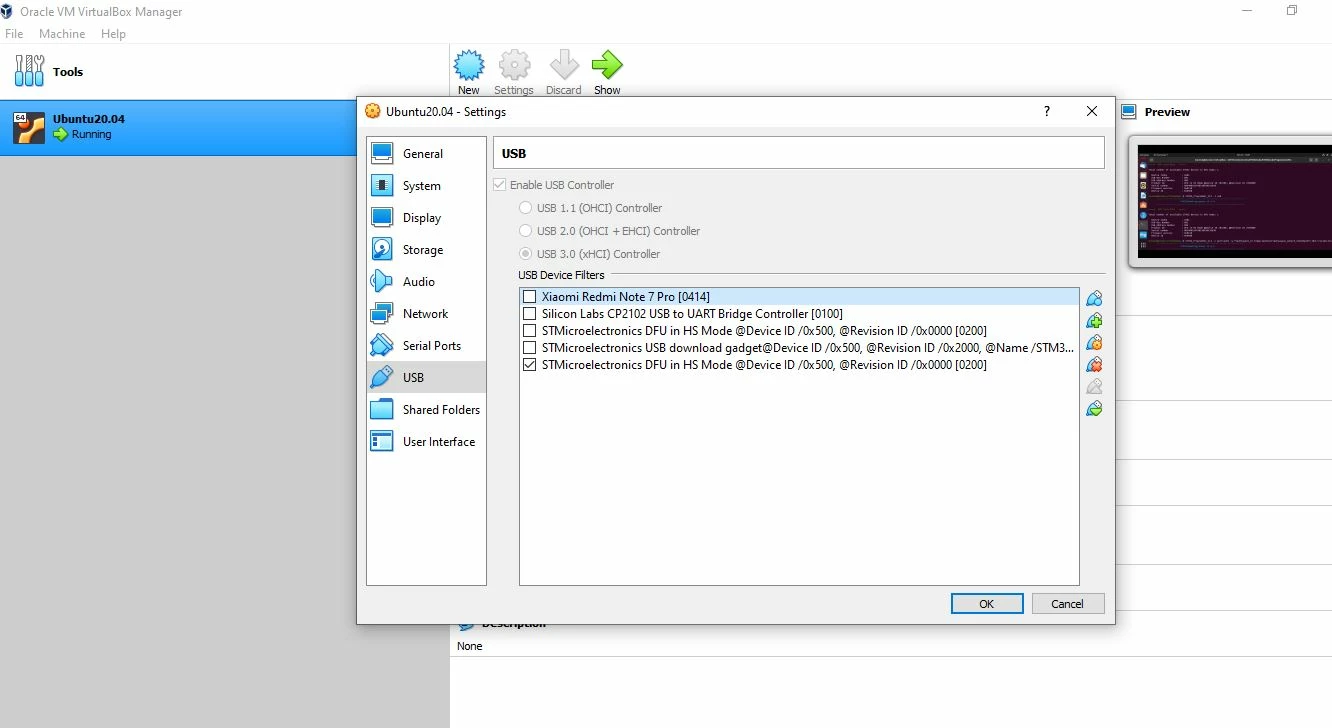

MVENN.1
MVENN.1Author
November 25, 2020
Hi PatrickF( ST Employee )
when i am given this command dmesg it showing
[26478.877667] usb 1-2: new high-speed USB device number 30 using xhci_hcd
[26479.363719] usb 1-2: New USB device found, idVendor=0483, idProduct=df11, bcdDevice= 2.00
[26479.363723] usb 1-2: New USB device strings: Mfr=1, Product=2, SerialNumber=3
[26479.363726] usb 1-2: Product: USB download gadget@Device ID /0x500, @Revision ID /0x2000, @Name /STM32MP157CAC Rev.B,
[26479.363729] usb 1-2: Manufacturer: STMicroelectronics
[26479.363732] usb 1-2: SerialNumber: 0034001A3438510438333630
[26516.580117] usb 1-2: USB disconnect, device number 30
I am not using USB OTG cable just i am using Typle c cable to my PC.
little bit I understand. Please guide me how to solve this issue.
Thanks.
PatrickF
November 25, 2020
your flash download seems ok, so if you reset the board, it should fly.
Best is to look at the console (ST-Link VCP) during boot.
Maybe a too weak supply (1A is barely ok, 2A is the minimum, 3A is recommended)
Could you please followup on https://community.st.com/s/question/0D73W000000VPAS to avoid two parallel discussion thread ?
