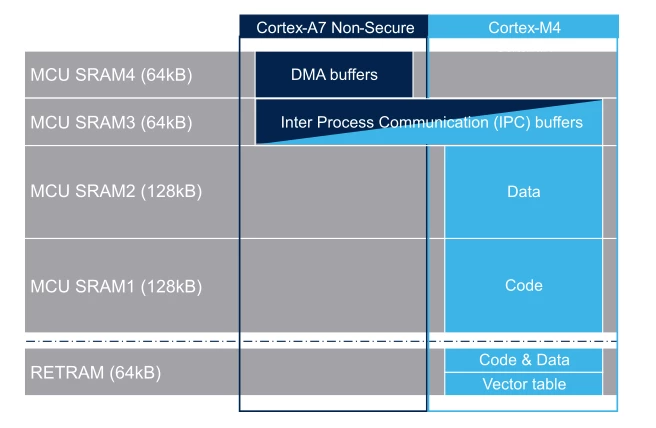

I can share data using RPMsg/OpenAMP. Now I'm trying to see if there is another way to share data, such as accessing memory instead of sending the information.
My idea is to write to the M4 core and then read it to the A7 core. I see that the SRAM space is shared between the processor:
0693W00000WJVTAQA5.pngCan I use this part of the memory to share data?
