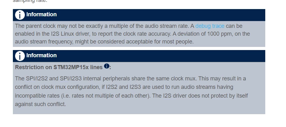

Hi
in one of link
https://wiki.st.com/stm32mpu/wiki/I2S_Linux_driver#Short_Description
can i2s1 used for mclk generation, and will the parent clock able to generate mclk for different audio different bitrate,
because in dk2 we use i2s2 for mclk generation, in our board we i2s1 with sgtl5000,
may you share the template for dts for sgtl5000 code with mclk for different audio playing 44100 and 48000 bitrates
