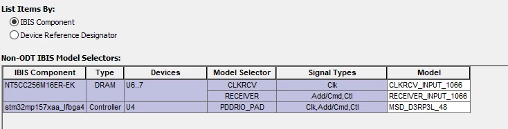

Hi everyone,
I have tried to check eval board PCB with hyperlynx DDR wizard but I can't.
I downloaded all of the IBIS data which are Nanya DDR3L ram and MP157A.
However, I'm confused about which ODT models I should choose.
Please help me which model I chose to pass this check.
By the way, I attached the odt model page screen.

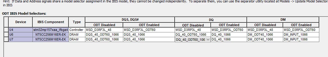

PatrickF
Jul 30, 2021 12:50 PM UTC
With a DDR3L you can set the values below for your simulation:
In write mode (ODT disabled on STM32MP1 side, ODT enabled on memory side)
  • Controller (STM32MP1) model are :
    • DQ and DM are MSD_D3RP3L_48
    • DQS is MSD_D3RF3L_48
    • CLK is defined PDDRIO_PAD, select MSD_D3RP3L_48
    • address and control are MSD_D3RP3L_48
  • DDR model is set with ODT 60 and frequency 1066.
In read mode (ODT enabled on STM32MP1 side, disabled on memory side)
    • DQ and DM are MSD_D3RP3L_ODT60
    • DQS is MSD_D3RF3L_ODT60
  • DDR model is set with Zout 40 ohm and frequency 1066
Regards,

gokhannsahin
Jul 30, 2021 1:33 PM UTC
How did you identify them? If I change parameters in CubeMX, do I need to change them too?
Also, when ODT is disabled, for DRAM, DQS40_ODT_60_1066 is right?

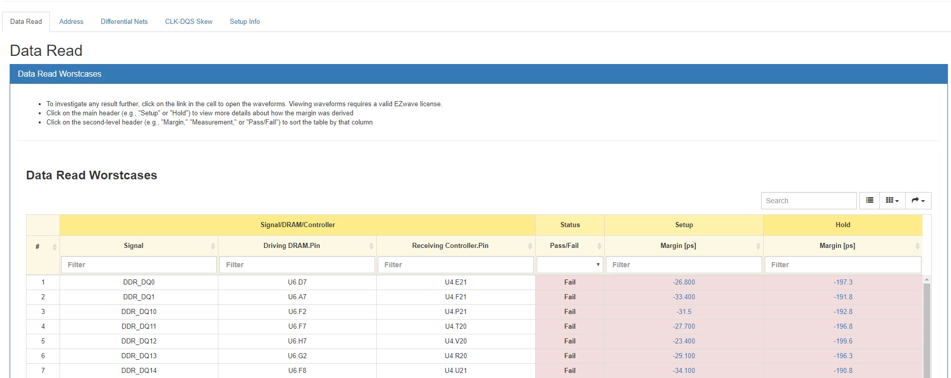

I attached the config image, is right?
0693W00000D17IgQAJ.png0693W00000D17QoQAJ.pngIf yes, it fails;

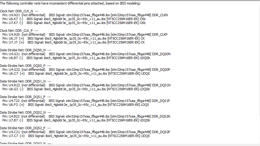

0693W00000D17QUQAZ.pngAlso, Hyperlynx gives a warning about MP1 Ibis data.

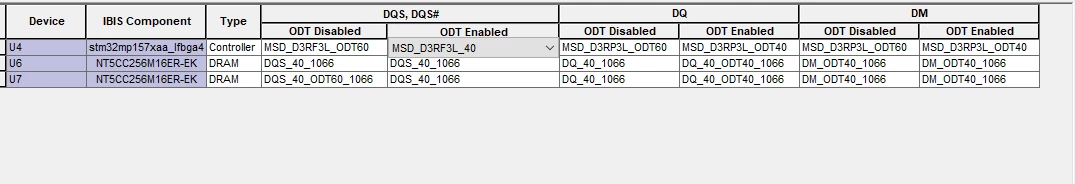

PatrickF
Jul 30, 2021 1:50 PM UTC
info in the IBIS file itself,
There are one description for the IO PDDRIO_PAD (for all single ended IOs and CLK/CLK#) and one description for the differential PDIFF_PAD (DQS)
e.g.
[Model Selector] PDDRIO_PAD
MSD_D3RP2_18 DDR2 MSD_D3R_PDDRIO Z0=18-Ohm
MSD_D3RP2_40 DDR2 MSD_D3R_PDDRIO Z0=40-Ohm
MSD_D3RP2_48 DDR2 MSD_D3R_PDDRIO Z0=48-Ohm
MSD_D3RP2_ODT150 DDR2 MSD_D3R_PDDRIO cell 150-Ohm ODT Receiver
MSD_D3RP2_ODT50 DDR2 MSD_D3R_PDDRIO cell 50-Ohm ODT Receiver
MSD_D3RP2_ODT75 DDR2 MSD_D3R_PDDRIO cell 75-Ohm ODT Receiver
MSD_D3RP2_ODTOFF DDR2 MSD_D3R_PDDRIO cell ODT off Receiver
MSD_D3RP3_34 DDR3 MSD_D3R_PDDRIO cell Z0=34-Ohm
MSD_D3RP3_40 DDR3 MSD_D3R_PDDRIO cell Z0=40-Ohm
MSD_D3RP3_48 DDR3 MSD_D3R_PDDRIO cell Z0=48-Ohm
MSD_D3RP3L_34 DDR3L MSD_D3R_PDDRIO cell Z0=34-Ohm
MSD_D3RP3L_40 DDR3L MSD_D3R_PDDRIO cell Z0=40-Ohm
MSD_D3RP3L_48 DDR3L MSD_D3R_PDDRIO cell Z0=48-Ohm
MSD_D3RP3L_ODT120 DDR3L MSD_D3R_PDDRIO cell 120-Ohm ODT Receiver
MSD_D3RP3L_ODT40 DDR3L MSD_D3R_PDDRIO cell 40-Ohm ODT Receiver
MSD_D3RP3L_ODT60 DDR3L MSD_D3R_PDDRIO cell 60-Ohm ODT Receiver
MSD_D3RP3L_ODTOFF DDR3L MSD_D3R_PDDRIO cell ODT off Receiver
MSD_D3RP3_ODT120 DDR3 MSD_D3R_PDDRIO cell 120-Ohm ODT Receiver
MSD_D3RP3_ODT40 DDR3 MSD_D3R_PDDRIO cell 40-Ohm ODT Receiver
MSD_D3RP3_ODT60 DDR3 MSD_D3R_PDDRIO cell 60-Ohm ODT Receiver
MSD_D3RP3_ODTOFF DDR3 MSD_D3R_PDDRIO cell ODT off Receiver
MSD_D3RPL2_34 LPDDR2 MSD_D3R_PDDRIO cell Z0=34-Ohm
MSD_D3RPL2_40 LPDDR2 MSD_D3R_PDDRIO cell Z0=40-Ohm
MSD_D3RPL2_48 LPDDR2 MSD_D3R_PDDRIO cell Z0=48-Ohm
MSD_D3RPL2_60 LPDDR2 MSD_D3R_PDDRIO cell Z0=60-Ohm
MSD_D3RPL2_80 LPDDR2 MSD_D3R_PDDRIO cell Z0=80-Ohm
MSD_D3RPL2_ODTOFF LPDDR2 MSD_D3R_PDDRIO cell ODT off Receiver
MSD_D3RPL_48 LPDDR MSD_D3R_PDDRIO cell Z0=48-Ohm
MSD_D3RPL_ODTOFF LPDDR MSD_D3R_PDDRIO cell ODT off Receiver
The simulation impedance should match the register config.
The ODTs impedance is programmable via ZQ0CR1.ZPROG[7:4]. Default and recommended value is 48 ohms.
The DQ/DQS output impedance is programmable via ZQ0CR1.ZPROG[3:0]. Default and recommended value is 60 ohms.
See also AN5168
Regards.

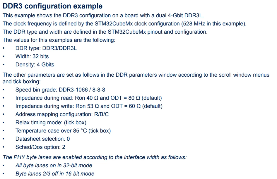

gokhannsahin
Aug 4, 2021 9:25 AM UTC
Your ref guide gives Ron and ODT the following image, why do we use 60ODT and 48R?
