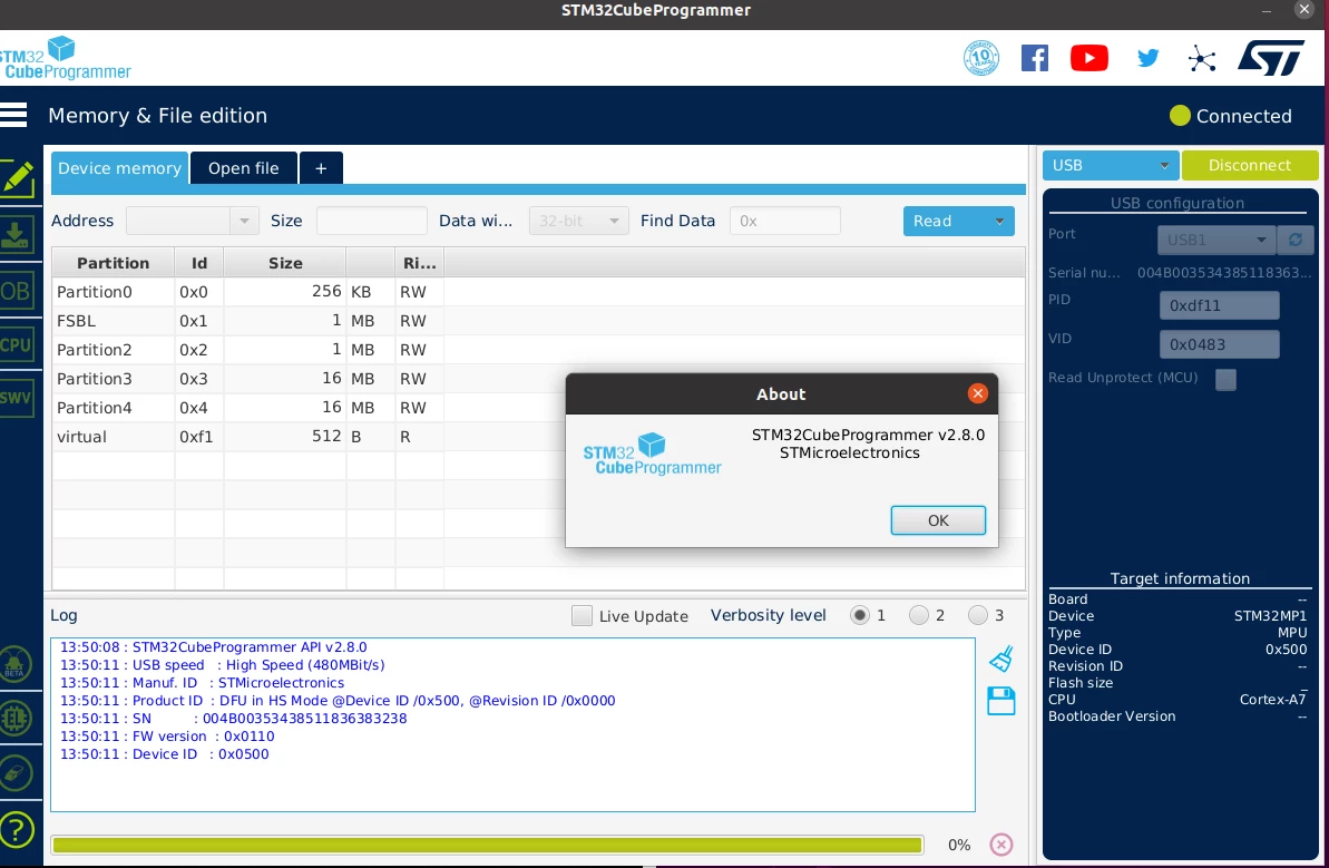

Hi!
I am following the instructions of this wiki page:
https://wiki.st.com/stm32mpu/wiki/Getting_started/STM32MP1_boards/STM32MP157x-DK2/Let%27s_start/Populate_the_target_and_boot_the_image
I have the DK2 connected to my system using the USB OTG port.
The boards dip switches are in the correct position.
I copied the udev rules to /etc/udev/rules.d/.
Pressing "Connect" results in following error:
 16:44:36 : STM32CubeProgrammer API v2.8.0
 16:50:03 : USB speed : High Speed (480MBit/s)
 16:50:03 : Manuf. ID : STMicroelectronics
 16:50:03 : Product ID : DFU in HS Mode @Device ID /0x500, @Revision ID /0x0000
 16:50:03 : SN : 003300293030510D32313933
 16:50:03 : FW version : 0x0110
 16:50:03 : Device ID : 0x0500
 16:50:03 : Error: CUBEPROGRAMMER_ERROR_NOT_SUPPORTED
What am I doing wrong?
Thank you in advance,
Gunther

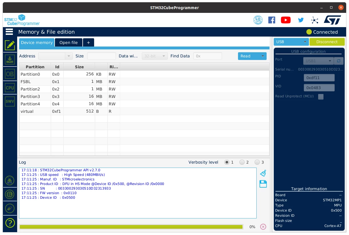

I have more information:
STM32CubeProgrammer-2.7.0 works, but STM32CubeProgrammer-2.8.0 does not.
But 2.7.0 still crashes when ST-LINK is also connected.

GLaure
GLaureAuthorBest answer
Oct 7, 2021 06:14 UTC
Hi Kevin,
Good morning!
The issue is rather trivial. If you change to its bin folder before starting it 2.8.0 works.
cd ~/STM32MPU_workspace/STM32MPU-Tools/STM32CubeProgrammer-2.8.0/bin
./STM32CubeProgrammer &
If it is started from another path , the app returns this error and connect fails:

It was just coincidence that 2.7.0 worked on my first try. The STM32CubeProgrammer startup script is missing the prefix $DIR variable to start the jre.
If this is fixed, it fails the same way as 2.8.0, when started from other working directories.
Hope that helps when you try to fix this issue.
Bye Gunther
Kevin HUBER
Oct 7, 2021 08:40 UTC
Hi @GLaure​ ,
Thank you for your help on this issue.
You are right, I was able to reproduce the problem on my Ubuntu. I even reproduced the crash related to ST-link if I run the STM32CubeProgrammer  from the folder just before bin, the folder STM32CubeProgrammer-2.8.0.
I will make a ticket to our developer team to talk about this problem.
