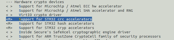

To modify that, you have to use the "make menuconfig" search the 3 configs "CONFIG_CRYPTO_DEV_STM32"
  Location:
 │   -> Cryptographic API (CRYPTO [=y])
 │    -> Hardware crypto devices (CRYPTO_HW [=y])
And press the space key several times until you have switched all of them into modules:

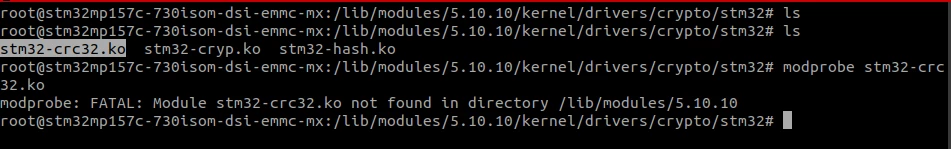

@Kevin HUBER​ Thank you for the quick response. I tried what you suggested. The module does get built and i can it inside the /lib/modules/kernel/drivers/crypto directory. But when i try to perform a modprobe it fails. Any clues why?
NPal.2
NPal.2Author
May 2, 2022 14:21 UTC
Never mind. I just checked that it has been loaded as stm32_crc . Looks good now thanks for the support.
