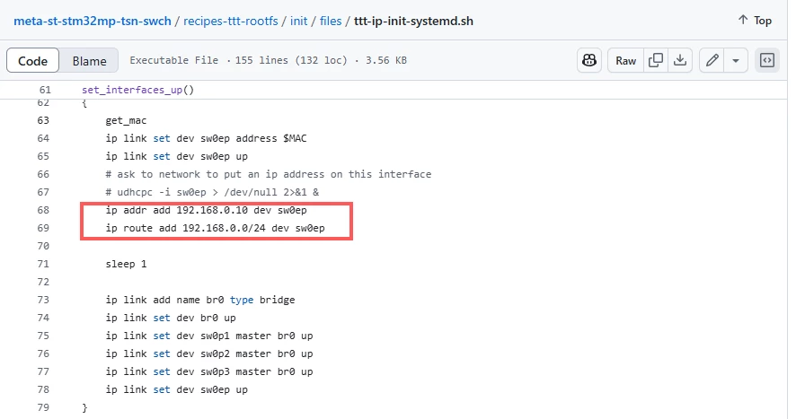

Can I only modify the ttt-ip-init-systemd.sh script if I need to change and persist the IP address while using the STM32MP switch mode?

June 27, 2025
YEs the script is there for that so you can customize it for your setup or product !
bugmanAuthor
July 1, 2025
Can I use the service in Systemd to set it up?
Bernard PUEL
July 4, 2025
Of course you can.
As soon as the switch driver is probed, the configuration is done by Kernel standard interfaces.
