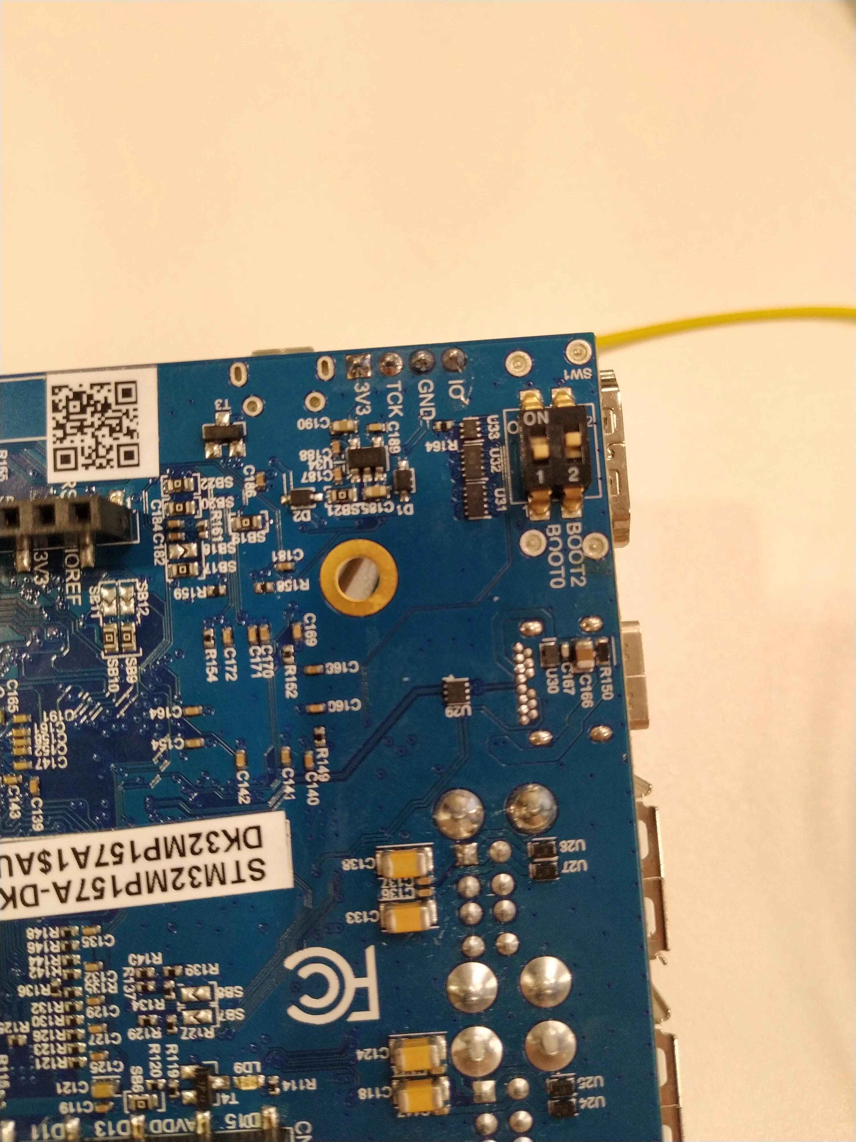

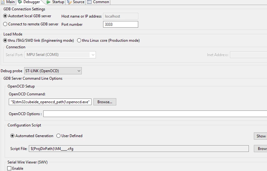

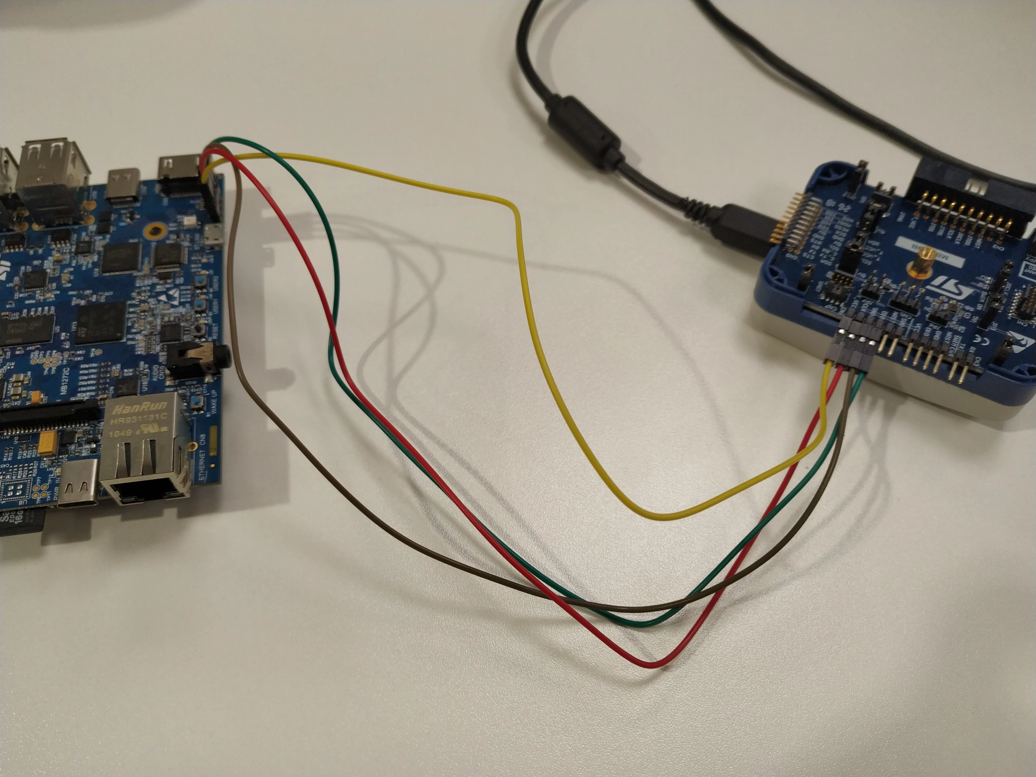

I am trying to debug in engineering mode with the STM32MP157A-DK1 through a external ST-Link V3 but i am not being able to get it to work. I attacht the error gotten, as well as pictures of the connection and the debug configuration in Cube IDE. The image thas shows the debug configuration has the OpenOCD option configured, however i have also tried the GDB option but the board is not even found in this case. Thank you in advance.

I think there is few misunderstandings.
There is an embedded STLINK (STLINK-V2) on STM32MP157A-DK1, to debug using this one, simply connect the PC on USB CN11. No need of an external STLINK-V3.
If you are willing to use a different probe (e.g. external STLINK-V3), you should solder wires on TP2, TP3, TP4...., see schematic page 3. Connection of external probe is more easy on EVAL board (e.g. STM32MP157F-EV1).
Note that embedded STLINK-V2 also provide UART4 console as USB Virtual Comm Port (VCP). This require additional wiring in case external STLINK-V3 is used (not available on external STLINK-V2).
Note: The unpopulated CN12 you are trying to use is the SWD port of the embedded STLINK-V2 itself, used only during board production to flash the initial STLINK FW, then this port is disabled and useless (if needed, STLINK FW update is done thru CubeProgrammer).

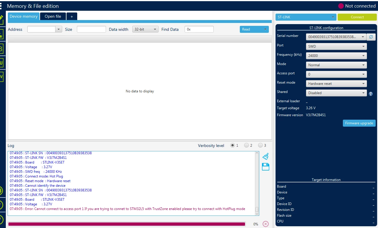

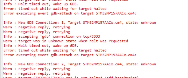

I have connected the STLINKV3 through TP2, TP3, TP5 and TP9. The first time the device has been identifed, although the debug has failed to start. After that the error is always the same and i can get it to work. I attach you an image of the error. I have checked the connection and it seems to be ok.

Note that CubeProgrammer with STM32MP15x cannot work with STLINK, but only connect using USB to load the platform flash.
STLINK is only used for debug purposes with e.g. debug Cortex-M4 FW with CubeIDE.
Engineering mode is only used to test and debug (e.g. the Cortex-M4 code), but the platform does not boot from any Flash in that mode.
Cortex-M4 FW is always loaded/started from uBoot or Linux, it cannot be used ad a standalone MCU.

Thank you really much! Really i have tested the STLINK in CUBEIDE and i was having that problem too. The first time it connected but after that the device is not found..i attached the picture with the programmer just in case if it was more clear there, i did not realise that it could not work with the STM32MP15x.
