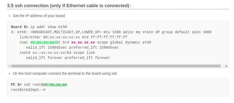

SSH connection to STM32MP15-DK2
I've try to connect to the through SSH but it's seem no sshd is running :
BOARD $> ssh root@xx.xx.xx.xx
BOARD $> ssh: connect to host xx.xx.xx.xx port 22: Network is unreachable
BOARD $> systemctl sshd -l
BOARD $> No ssh.service found
I would like to install openssh through apt but I can't found any package.
Indeed /ect/apt/sources.lsit.d is empty.
Currently How to manage the debian packages in OpenSTLinux distribution doesn't provide any information.
Can someone told me how install openssh with apt on the board ?

So I found the mistake, in the wiki the address used is the brd address instead the inet address.

For my part the ip addr show eth0 address give me a valid brd address. My board is connected to my pc via rj45 and I can ping servers.

Don't search for a sshd, you have "dropbear" installed as your ssh server. Do you find that:
root@stm32mp1:~# ps -ef | grep dropbear
root    710   1 1 18:17 ?    00:00:00 /usr/sbin/dropbear -i -r /etc/dropbear/dropbear_rsa_host_key -B
And with netstat you should find something listening on port 22
root@stm32mp1:~# netstat -tuln

Yes I see something listening on port 22 but when I try to connect to the board I get ssh: connect to host XX.XX.XX.XX port 22: Network is unreachable.
I'm sharing my wifi through rj45 maybe the problem is here ?
RMarg
RMargAuthorBest answer
October 3, 2019

Ok, what you used is the so called "Broadcast" Address :) Never use that for a connection.
