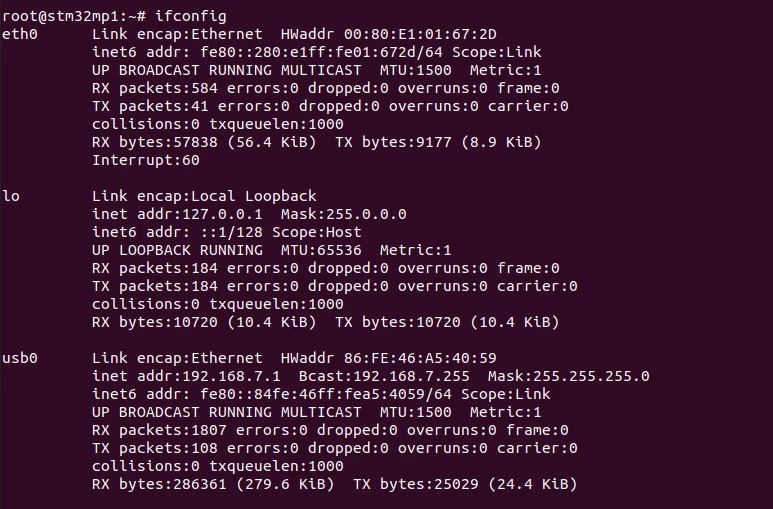

Firstly command "ifconfig" on my board:

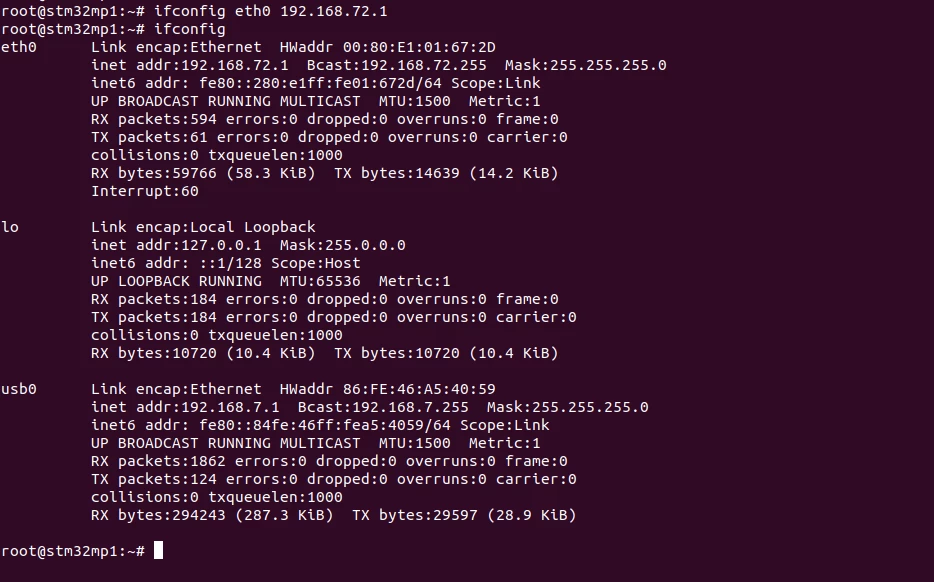

Ifconfig responds eth0 that has not IP adress. Therefore I set manually IP adress this command and type ifconfig again:
Finally on my host computer, I want to connect the terminal to the board using ssh:
I take ssh: connect to host 192.168.72.1 port 22: Connection timed out error

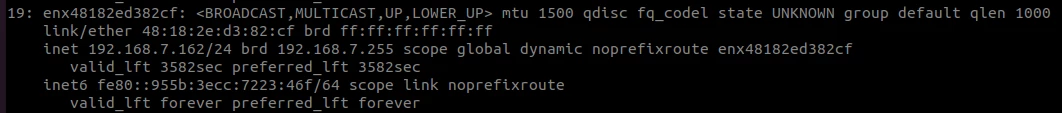

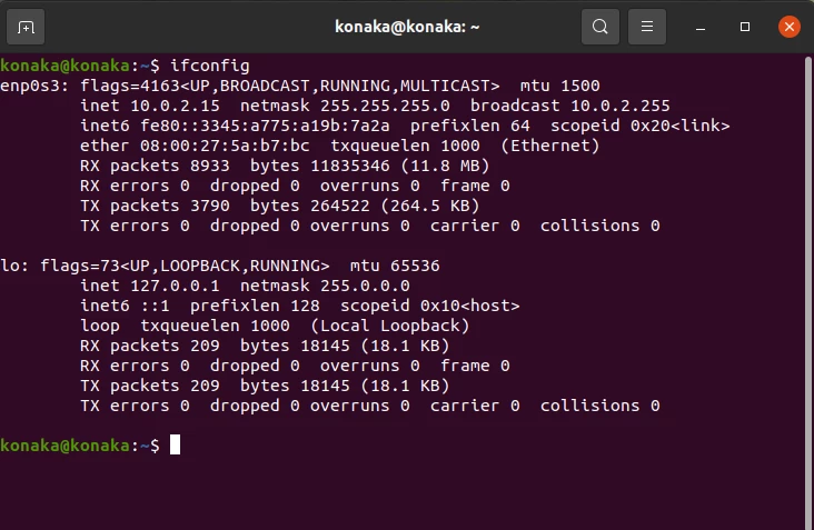

The command ifconfig on my Ubuntu PC
Thanks

From what I see with your screenshot, you don't have a subnet shared between your board and your PC so you can't communicate between them.

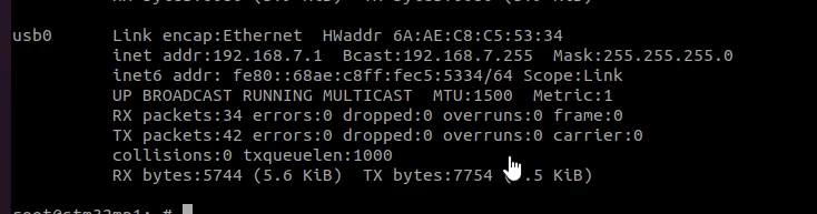

For example, on my PC with my DK2 plugged via usb0 (ethernet):
0693W00000NppfYQAR.pngThe IP of the board is 192.168.7.1

I solved this problem.
First I set Board IP as statice ip:
root@stm32mp1:~# ifconfig
eth0 Link encap:Ethernet HWaddr 00:80:E1:01:67:2D
 inet addr:192.168.72.2 Bcast:192.168.72.255 Mask:255.255.255.0
 inet6 addr: fe80::280:e1ff:fe01:672d/64 Scope:Link
 UP BROADCAST RUNNING MULTICAST MTU:1500 Metric:1
 RX packets:3954 errors:0 dropped:0 overruns:0 frame:0
 TX packets:1479 errors:0 dropped:0 overruns:0 carrier:0
 collisions:0 txqueuelen:1000
 RX bytes:389397 (380.2 KiB) TX bytes:110373 (107.7 KiB)
 Interrupt:60
lo Link encap:Local Loopback
 inet addr:127.0.0.1 Mask:255.0.0.0
 inet6 addr: ::1/128 Scope:Host
 UP LOOPBACK RUNNING MTU:65536 Metric:1
 RX packets:970 errors:0 dropped:0 overruns:0 frame:0
 TX packets:970 errors:0 dropped:0 overruns:0 carrier:0
 RX bytes:81460 (79.5 KiB) TX bytes:81460 (79.5 KiB)
usb0 Link encap:Ethernet HWaddr B2:7C:6A:40:F8:35
 inet addr:192.168.7.1 Bcast:192.168.7.255 Mask:255.255.255.0
 inet6 addr: fe80::b07c:6aff:fe40:f835/64 Scope:Link
 RX packets:2927 errors:0 dropped:0 overruns:0 frame:0
 TX packets:356 errors:0 dropped:1 overruns:0 carrier:0
 RX bytes:319747 (312.2 KiB) TX bytes:77331 (75.5 KiB)
And second plug USB-OTG cable to my computer and board and I enabled it in the devices tab in VirtualBox and disable and enable the connect network adapter tab in VirtualBox.
