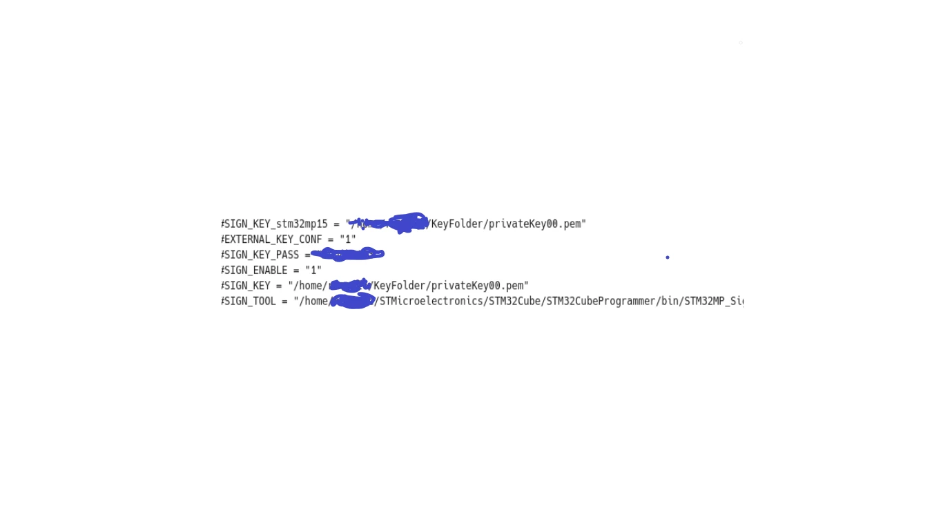

Jul 30, 2024 07:44 UTC
Hi Kevin,
 I already have it enabled in  my yocto build as shown below but the error persist.
Kind regards,
Basit
Kevin HUBER
Aug 7, 2024 13:33 UTC
Hello @ao2-yekeen ,
This should normally works. I will give it a try on my side and see if it works.
Just to be sure, in the screenshot that you shared, it looks like there is "#" at the beginning of each lines. Which means that the lines are commented in the "local.conf" and therefore not taken into account.
Can you confirm that they appear without the "#" at the beginning of the line in the configuration file?
Or if you can share the whole local.conf file (without the passkey).

Sep 19, 2024 10:40 UTC
Hi, Kevin,
Attached below is the contents of my local.conf file.
Kind regards,
Basit
