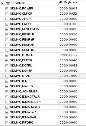

SDMMC3 is not working on STM32MP157F-EV1 board.
Hi, Community,
I'm not sure what's wrong.

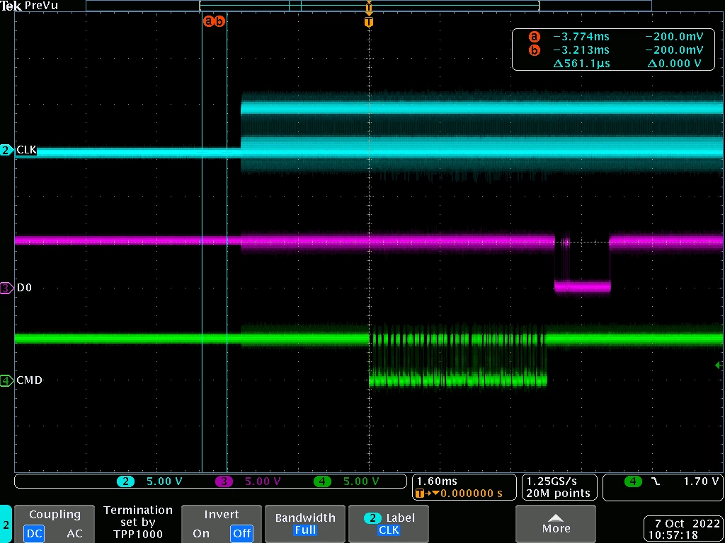

I can confirm that SDMMC3_CK/CMD/D0 signals are input and output by osilloscope,
but SDMMC_FIFO is empty.

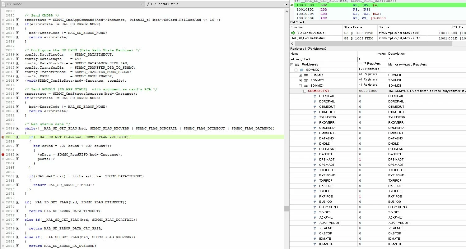

The following code is part of the SD_SendSDStatus function in stm32mp1xx_hal_sd.c
static uint32_t SD_SendSDStatus(SD_HandleTypeDef *hsd, uint32_t *pSDstatus)
 /* Send ACMD13 (SD_APP_STAUS) with argument as card's RCA */
 errorstate = SDMMC_CmdStatusRegister(hsd->Instance);
 if(errorstate != HAL_SD_ERROR_NONE)
 hsd->ErrorCode |= HAL_SD_ERROR_NONE;
 return errorstate;
 /* Get status data */
 while(!__HAL_SD_GET_FLAG(hsd, SDMMC_FLAG_RXOVERR | SDMMC_FLAG_DCRCFAIL | SDMMC_FLAG_DTIMEOUT | SDMMC_FLAG_DATAEND))
 if(__HAL_SD_GET_FLAG(hsd, SDMMC_FLAG_RXFIFOHF))
 for(count = 0U; count < 8U; count++)
 *pData = SDMMC_ReadFIFO(hsd->Instance); ★★★NOT REACHABLE!!!★★★
 pData++;
 if((HAL_GetTick() - tickstart) >= SDMMC_DATATIMEOUT)
 return HAL_SD_ERROR_TIMEOUT;
 return HAL_SD_ERROR_NONE;

TSens.1Best answer
Oct 10, 2022 23:45 UTC
I'm ashamed to say this�?but..
As a matter of fact, the signal line connecting the board to the SD card module was disconnected.
I was so ashamed that I wanted to crawl under the rug.
Regards,​
