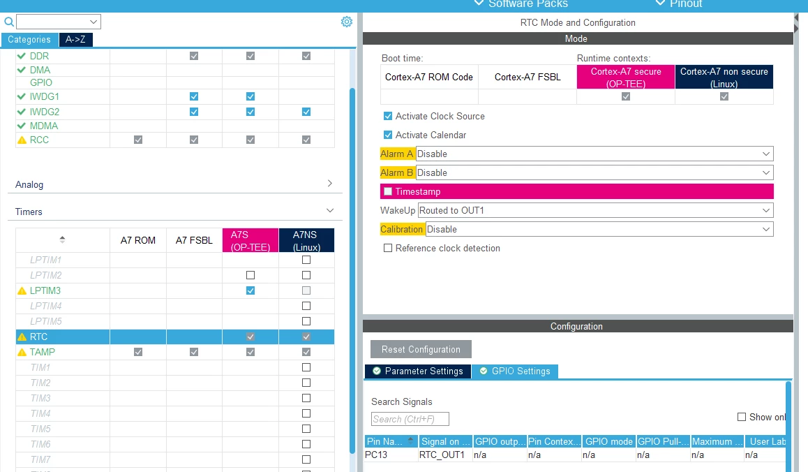

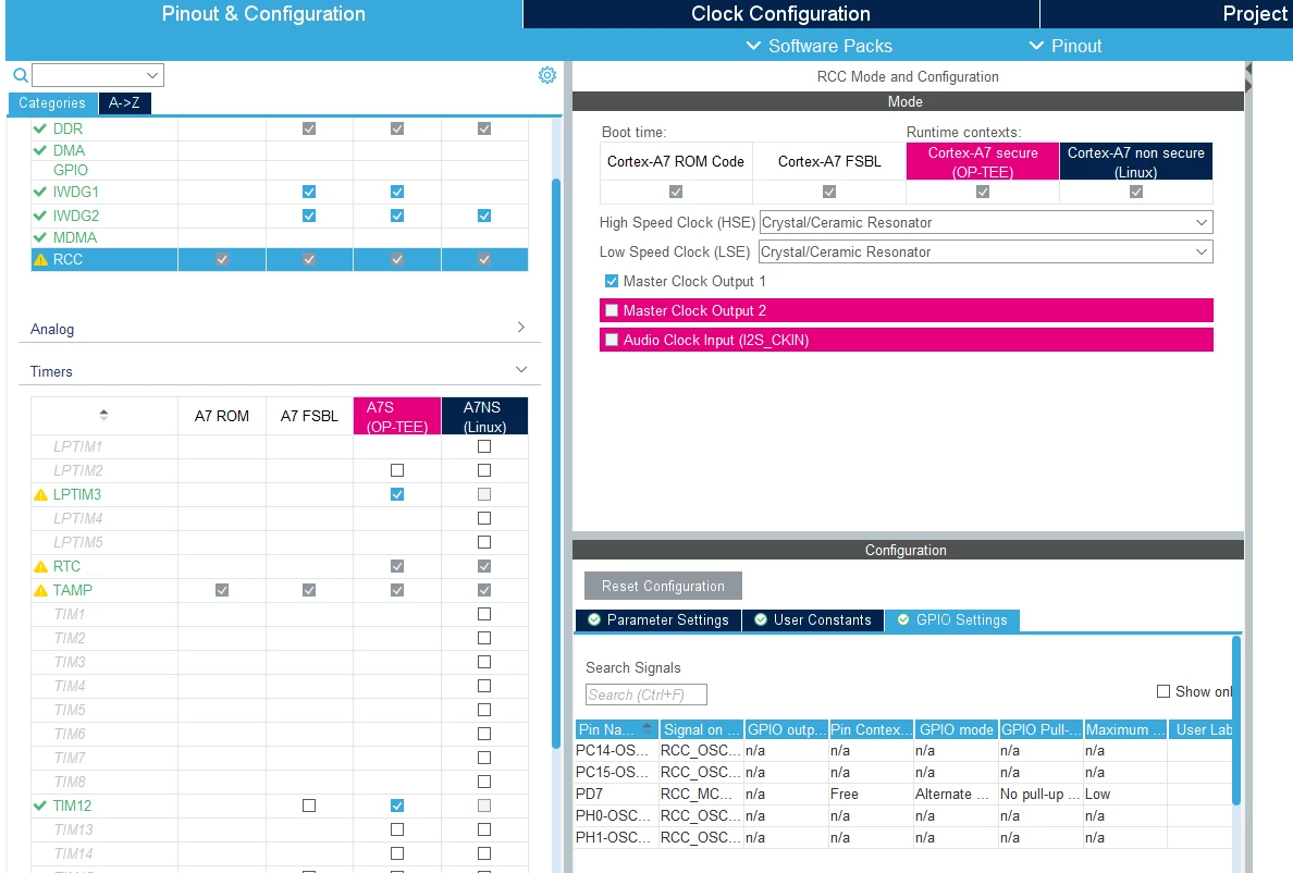

February 22, 2024
Cube MX Configs for RTC.
February 27, 2024
Hello, @Olivier GALLIEN, could you help me with this or tag someone who could help? Thanks. I believe that the RTC is very basic but I cannot find what I am missing.
