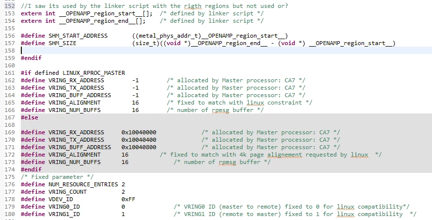

iam trying to get a full understanding of remoteproc and its resource tabel. In the paper i read i understood it that the resource table is used to give the information about the vrings location to the master and the slave. The master parses the ressource table during starting. When i had a look at my code i saw that the adresse of the vrings are set to -1 (attached picture). So iam confused about it really works. Does the master knows the location from the device tree and give it through the slave? And how does the master knows where it has to load the elf-File from the M4, also from the device tree? In the linker script i saw that the regions of the memorys are define but i guess never really used in the code.

All Information is contained in the elf file and the device tree.
1) The elf file contains the address and the size of the memory section to load, you can have this information with following command
$> readelf -S ./STM32CubeIDE/CM4/Debug/OpenAMP_TTY_echo_CM4.elf
There are 27 section headers, starting at offset 0x294430:

In this example the resource table is loaded at address 0x10020138.
This is the way the Linux remoteproc find the resource table address.
If the firmware is loaded by U-boot or OP-TEE, the resource table address is retrieved from a backup register written by the loading component.
Something important is that the resource table is read only for the Cortex-M4, only the Cortex-A7 should update it.
2) resource table initialization for RPMsg/virtio communication
The addresses of the Vrings and RPMsg buffers areas are allocated by the Linux thanks to information provided in the device tree memory regions. These addresses are computed by the Linux kernel remoteproc core for the vrings and by the rpmsg virtio bus for the RPMsg buffers.

vdev0vring0 is the memory region used to store the vring[0]
vdev0vring1 is the memory region used to store the vring[1]
vdev0buffer is the memory region used to store the Rpmsg/virtio buffers.
Other memory regions define the regions for the firmware code and data.
The -1 in the resource table means that the cortex-M4 doesn't impose an address. It's recommended for the stm32mp1 Socs not to change this value, and to use the memory region to update the addresses.
When the Linux kernel is ready to communicate ( resource table is updated), it sets the status field in the fw_rsc_vdev resource table structure. This informs the Cortex-M4 that the Vrings structures have been initialized and that the RPMsg communication can start.
