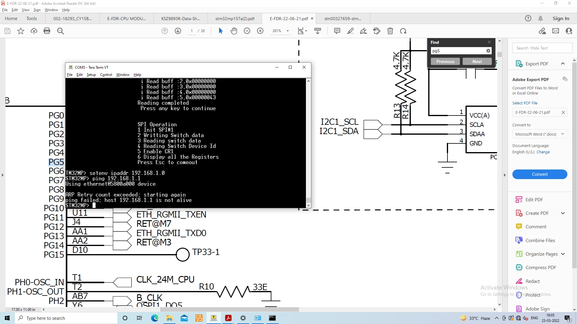

Sindhu Vadde
Mar 23, 2022 12:43 UTC
ping is working in Rmii mode. Now we switched to RGMII mode.but ping is not working.
we attached one document below for your reference.
OlivierK
Mar 24, 2022 10:55 UTC
Hi Sindhu,
I can't see well your schematics, it is a screen capture with the console in the middle.
but do could you monitor the 125MHz clock?
what if you do: mii dump 0 1 ?
MAC address has been provided?
Regards,
Olivier
Sindhu Vadde
Mar 25, 2022 04:44 UTC
Hi
yes i am monitring 125Mhz clock.
when i gave mii dump 0 1 i didnot seen any response(i.e,blank screen).
yes i have given MAC address as 12:34:56:78:9a:bc.
