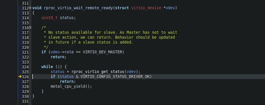

Hi everyone!
By default, the linker file describes that the memory partitions are configured as:
  1. RETRAM - ISR Vector;
  2. SRAM1 - Code;
  3. SRAM2 - Data;
  4. SRAM3 - buffer IPC;
  5. SRAM4 - not used in .ld file, but in device tree it's DMA1/DMA2 buffer.
My application does not need DMA buffers and I want to use this memory efficiently, namely:
  2. SRAM1+SRAM2 - Code;
  3. SRAM3 - Data;
  4. SRAM4 - buffer IPC;
To do this, I change the linker file accordingly:

I am also editing the device tree file(edit adress from 10040000 for IPC to 10050000 (SRAM4)):
		mcuram2:mcuram2@10000000{
			compatible = "shared-dma-pool";
			reg = <0x10000000 0x40000>;
			no-map;
		vdev0vring0:vdev0vring0@10050000{
			reg = <0x10050000 0x1000>;
			no-map;
		vdev0vring1:vdev0vring1@10051000{
			reg = <0x10051000 0x1000>;
			no-map;
		vdev0buffer:vdev0buffer@10052000{
			reg = <0x10052000 0x4000>;
			no-map;
		mcuram:mcuram@30000000{
			reg = <0x30000000 0x40000>;
			no-map;
		retram:retram@38000000{
			reg = <0x38000000 0x10000>;
			no-map;
		gpu_reserved:gpu@d4000000{
			reg = <0xd4000000 0x4000000>;
			no-map;
And i delete it:
&sram {
 dma_pool: dma_pool@0 {
 reg = <0x50000 0x10000>;
 pool;
And it:
&dma1 {
	sram = <&dma_pool>;
&dma2 {
	sram = <&dma_pool>;
But nevertheless, my application on the M4 core runs only in engineering mode. In production mode, the application hangs in an infinite loop:

Hello @AlexandrShipovsky​
The Cortex-M4 hangs waiting that the Linux updates the vdev status to initiate the RPMsg communication.
In a first review I see one issue in DT. You should extend MCURAM size for code+data
-			reg = <0x10000000 0x40000>;
+			reg = <0x10000000 0x50000>;
			no-map;
-			reg = <0x30000000 0x40000>;
+			reg = <0x30000000 0x50000>;
			no-map;
If this does not fix the issue, please could you provide the map file and/or elf file of your Cortex-M4 firmware and Linux kernel trace associated to the start of the M4 firmware?

It's really worked. Thank you!
