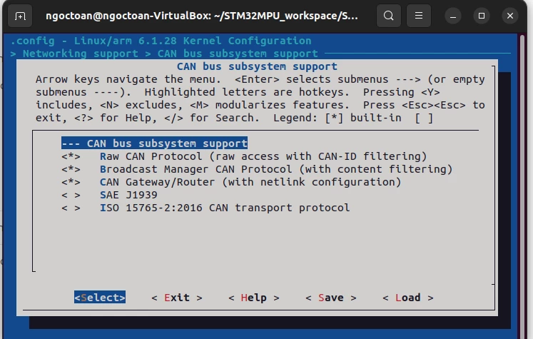

I am setting up the fd-can protocol on stm32mp1, please let me know after creating the dts file from stm32mx , how to transfer that file to stm32mp1 to use, do I use the command root@stm32mp1:~# ls / sys/class/net
end0 lo usb0 , it doesn't show that there is can0 , and I have another question
when I type like this there is flexcan , does it have any effect?

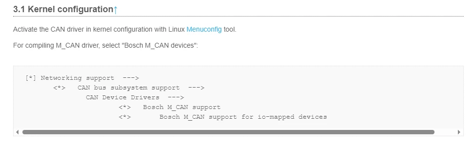

    hi, I have a problem when controlling FDCAN, there is no option as instructed
