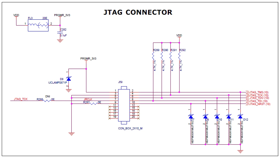

Query on JTAG connector pinouts for STM32MP131 MPU
Currently we are working on a design with STM32MP131A MPU. We came across "Getting started with STM32MP13x lines hardware development" document in that JTAG connector pinouts mentioned is matching with STLINKV2 whereas in our design we have used the below pinouts(as per image) which will be matching with STLINKV3 pinouts
So, Please suggest us whether can we go with STLINKV3 pinouts or STLINKV2 pinouts for JTAG connector

Hi @MB.13 ,
For STLINKV3, we recommend using STDC14 as described in AN5474
Regards.
