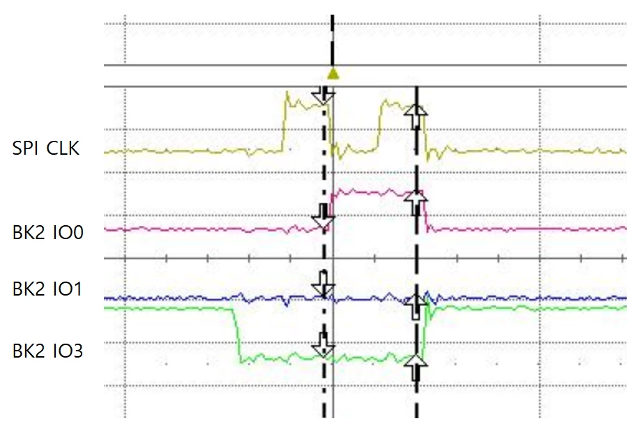

I am trying to operate two devices using QuadSPI in the STM32MP131 bare-metal environment. Currently, an external Flash is being used in QuadSPI Bank1 in dual mode, and I am attempting to use another external device in Bank2 in quad mode.
The issue I encountered is that while the Flash connected to Bank1 operates normally, a problem occurs when transmitting data to Bank2. Upon inspecting with an oscilloscope, the data itself is transmitted correctly, but the default state of the BK IO3 pin is always fixed to High. Since the external device receives data from QuadSPI without any filtering, the fact that IO3 is fixed to High can cause malfunction. *This device does not require separate NCS or WP pins.
The image below is a measurement taken when 0x01 was transmitted to BK2 using 4-line Quadmode.
Although 0x01 is transmitted correctly, you can see that the state of IO3 returns to High again.
To prevent any potential issues, the qspi-related code that activates the Flash has been disabled.
Below is the relevant code.

StnoobsAuthor
September 13, 2024
When power is initially applied, IO3 remains in a Low state and is not pulled up on the PCB.
In the CubeMX settings, it is configured as No PUPD (no pull-up/pull-down).
After transmitting data, it becomes fixed in a High state.
Additionally, there is something strange with the PF9 pin, which operates as BK1 IO1 and BK2 IO3.
When this pin is set as BK1 IO1 and 4-line data is transmitted, it returns to the normal Low state after data transmission. However, when configured as BK2 IO3 and data is transmitted, it becomes fixed in a High state after transmission.
Given this, I believe it is not a circuit issue.
PatrickF
September 13, 2024
I'm not expert on QUADSPI, but I think at then end of transfer, the IOs should go in Hi-Z.
Did you check the NCS going high ?
Did you try a pull-down ?
Maybe check that a byte write is effectively done to QUADSPI_DR register (and not 32-bit value).
Regards
