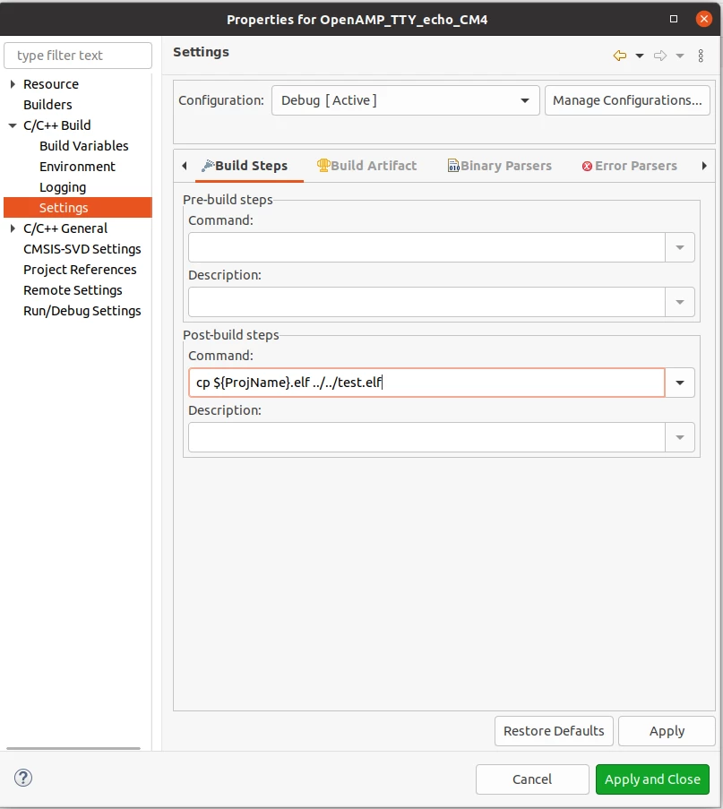

Hy there!
I'm new on ST platforms and development environments (I'm used to Netbeans-like ones).
Well, I would like to copy (automatically) both .elf executable and the .map files in given folder after building the projet.
This folder ("Out") is placed inside the project path.
I tried by adding a post-building step but i'm not able to find makefile variables sutch as ${ProjName} and so on...
I need those variables to automate the process throgh several configurations.
Where are defined those variable and what they contain?
I saw them, looking at the project options but I'm not able to find a guide to use them to write a building step as I'm used to do in other environments...

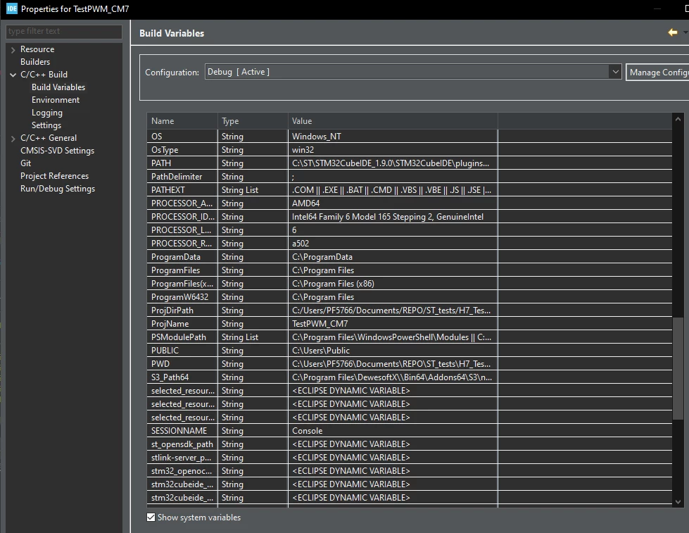

First good fact: following your suggestions and exploring a little bit more the environment i found a list containing a lot of environment variables.
0693W00000QKHJsQAP.pngOpening the Project properties -> C/C++ -> Build Variables and checking the voice "Show system variables", will display a comprehensive variable list...

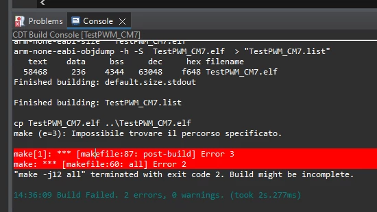

The problem now is that building fails beause makefile seems "Unable to find specified path"
I tried following exactly your example, giving manually full paths and also using environment variables; but the result is always the same.
What I understand watching the console is that now file and paths are correctly expanded in the post-build step, but command fails for some reason.
 Could be a "/" vs "\" issue...

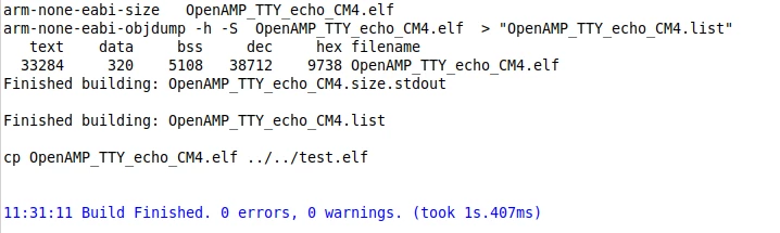

I made a quick test with STM32CubeIde 1.10 and ${ProjName} seems available in post build step:
After the build, the copy is done as expected:

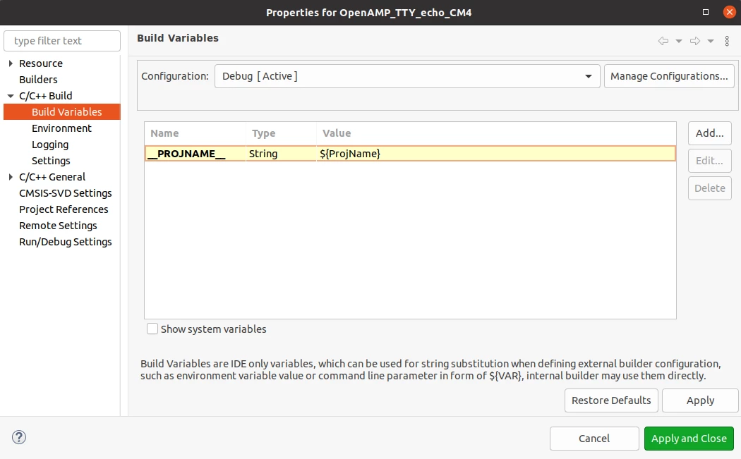

If you still can't access to this variable, you can try to configure a build variable in the property of your project and you set its value to ${ProjName}:

Hello @iTTy​ ,
Did you success to execute the cp command?
In linux you have to use "/" and in windows "\".
On which OS are you trying to use the CubeIde? Do you still need help?
