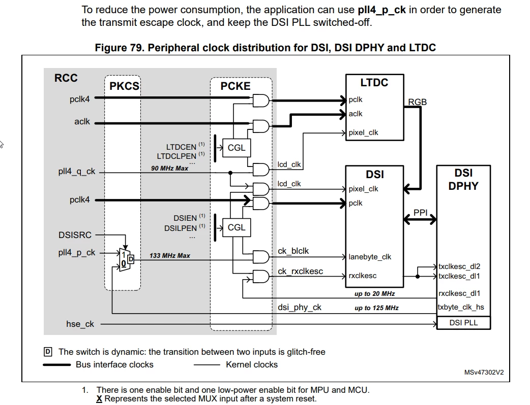

The error that you encounter "*ERROR* Unable to get peripheral clock: -517" is made by the file "drivers/gpu/drm/stm/dw_mipi_dsi-stm.c" when he tries to get the "pclk":
	pclk = devm_clk_get(dev, "pclk");
	if (IS_ERR(pclk)) {
		ret = PTR_ERR(pclk);
		DRM_ERROR("Unable to get peripheral clock: %d\n", ret);
		goto err_dsi_probe;
I don't know why, but the code seems to be unable to get the kernel peripheral clock of the DSI on your board. This pclk is defined in "stm32mp157.dtsi":
dsi: dsi@5a000000 {
	compatible = "st,stm32-dsi";
	reg = <0x5a000000 0x800>;
	phy-dsi-supply = <&reg18>;
	clocks = <&rcc DSI_K>, <&scmi0_clk CK_SCMI0_HSE>, <&rcc DSI_PX>;
	clock-names = "pclk", "ref", "px_clk";
By looking at the refman RM0436.pdf v5.0 page 572:
0693W00000LyimIQAR.pngWe can see that the pclk is pclk4.
So I don't know why pclk4 is not available with your board.

After more investigation, the trace:
 [drm:dw_mipi_dsi_stm_probe] *ERROR* Unable to get peripheral clock: -517
is a Probe_DEFER error that happens because the kernel tries to probe too early the DSI. The clock is not yet available.
Then the clocks are enabled by RCC and they are available once the system completed the boot.
I am searching why this happens in your case and not with the DSI screen of the 157C-DK2. You are using the driver ili9881c for your panel, which is an upstreamed driver and your modifications are very lite, so for the moment I don't understand the problem.
Is it possible to test with the latest version of ecosystem (v3.1)?
In your log, you are using the Linux 5.10.10, the linux version of the ecosystem v3.0, but I can see on github that there were some patches related to the Probe_DEFER for the drm part.
