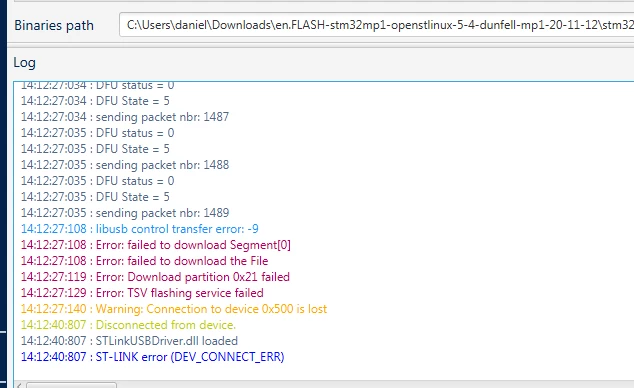

Problem flashing SD CARD on STM32MP157A-DK1

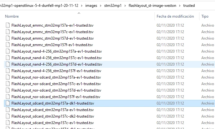

I have been trying to flash the SD card of the STM32MP157A-DK1 following the instructions of the ST Wiki, although in this wiki the board used is the DK2. However the flashing process stops after a while and shows the errors that i attach in the pictures. The CubeProgrammer version is the 2.6. After some research i saw that another option could be execute the flashing process from the command shell but i have not been able to do it because it never finds the file to be flashed, despite copying it in the STM32CubeProgrammer\bin folder. Thanks in advance.

I assume you are using W10 PC.
Once you have installed latest CubeProgrammer and downloaded/unzipped the starter package on a local folder,
  • Go to ...\images\stm32mp1 folder
  • Connect board as defined in Getting started
    • Check boot switches
    • Connect USB Type A to Type C cable between PC and CN7/USB_OTG port of the STM32MP157x-DK2 board
    • Power up the board
  • Use the following command on the PC: "%ProgramFiles%\STMicroelectronics\STM32Cube\STM32CubeProgrammer\bin\STM32_Programmer_CLI.exe" -c port=usb1 -w flashlayout_st-image-weston\trusted\FlashLayout_sdcard_stm32mp157A-dk1-trusted.tsv
Regards.

Thank you so much! This worked!
