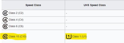

I've tried to flash the microSD card (SANDISK 16GB) using both methods provided in the guide.

Olivier GALLIEN
Aug 9, 2024 9:23 AM UTC
Hi @Zim ,
Following the message :
dd: fdatasync failed for '/dev/sdf': Input/output error
It's possible that the sdcard is broken : did you tried with another sdcard ?
Can you provide exact reference of your board?

I don't think my SD card is broken because I was able to flash it with an image for a different board, and it worked.
I' m using a 16 GB SanDisk microSD card with the following markings on it:
